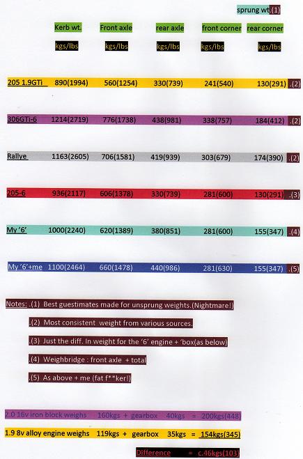

fangio
This is a chart I made up recently to help with ascertaining the right springs and is therefore more GTi-6 engine related, but as this is becoming the engine of choice it may be useful? Anyway:
Sorry this hasn't copied over the way it looked in the preview.
Edited by fangio
fangio
My '6' has extra unsprung wt in the form of '6' brakes and sprung wt. of box of breakdown stuff and sub/amps all of which adds abouy 55kgs.
