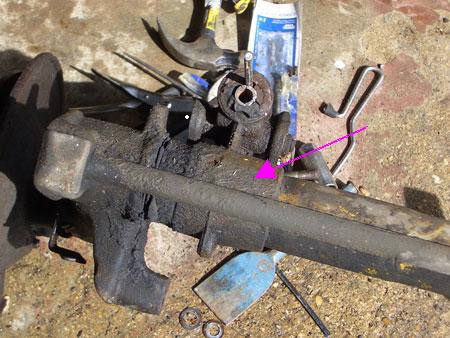

mhyphenl 10 1 Cars Posted December 31, 2008 (edited) I'd say that it's VERY unlikely that you've bent the main beamtube if everything else is straight and serviceable - things like stub axles usually bend long before the beamtube, and trailing arms can bend/snap and still leave the tube straight. It's more likely from your description that something removeable is wrong - the sandwich mounts can be put on two ways, one of which will make it approximately an inch out because the mounts are offset. Also, make sure the mount/leg thing that the damper and sandwich mount bolts to is straight, as that can be easy to bend with the beam off the car - if it's damaged, it can be easily replaced as it just bolts to the tube. Finally, make sure that the front (double) mounts are both identcal (1.9 ones are different to others) and round the correct way, as that can give odd effects like one wheel being further forward than the other. Hi guys, Its this part thats twisted in relation to the other side, don't know how or if it can be re positioned. any clues anyone? Its the bit that holds the fixed end of the torsion bar and the mount for the front attachment. Edited December 31, 2008 by mhyphenl Share this post Link to post Share on other sites
Anthony 1,003 Posted December 31, 2008 AFAIK that part is pressed onto the tube, and I guess in theory could be moved round with some brute force and leverage - I've never knowingly had one of them move though and haven't ever had to press one on or off, so I don't speak from experience. Share this post Link to post Share on other sites
