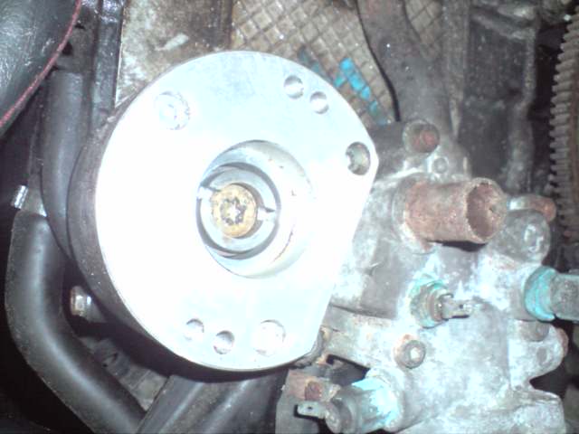

I have made my own dizzy adaptor for my mi16 engine which i have put in my 205 gti. I am looking for some pictures of the little piece that you put on the camshat. I need to check whether i have put the "slice" for the dizzy to grip on to in the right side of the adaptor piece. If i have made it right i will put up some pictures on how to make this converter. It is very simple yet very good.
So does someone have some pictures of an 8v dizzy adaptor? It is not because i am cheap or anything, it is simply just because i live in denmark and if i were to order one i would have to wait. So just to try it out i made my own last night, which is surprisingly effective and stabil. So i just wanted to check if i have done it right.

The housing fits yes. But the inner bit is different. On an 1.9 gti camshaft the "groove" that the distributor grips on to is on the end of the camshaft. On an my16 camshift the "groove" is on the side of the end of the camshaft. Kinda hard to explain. Hope you understand.

Exactly - well overpriced! And i am pretty sure i have done it right. But i need to see pictures from both back and front of that little bit, since i need to now if the "center pulley" adjustment is right. Otherwise ignition will be 180 degrees wrong.

I dont know if you would be interested but i have a couple of the adaptors lying around that i had made when i did my MI16 conversion, the part you need that bolts onto the end of the camshaft and allows you to bolt on the GTI thermostat housing.
Just beware that you will also need to drill and tap the MI16 head in a couple of places for the bolts to allow the GTI housing to attached properly...
