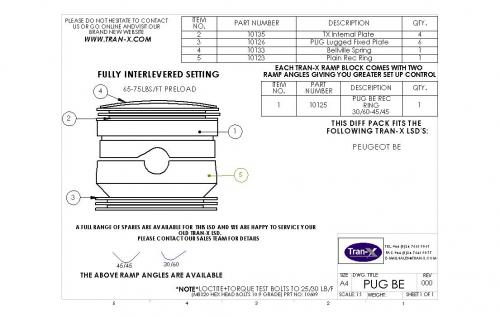

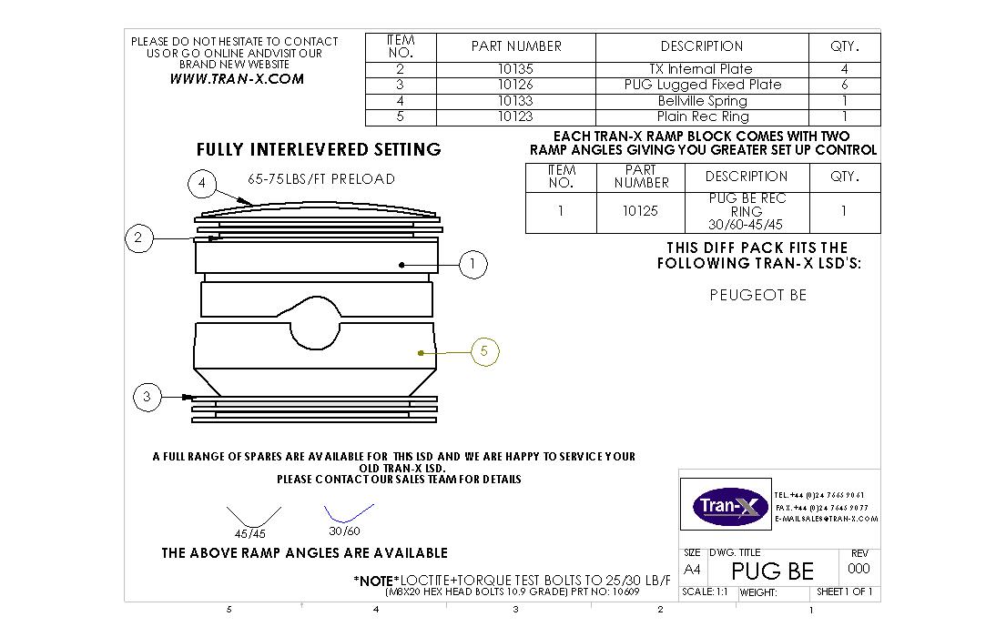

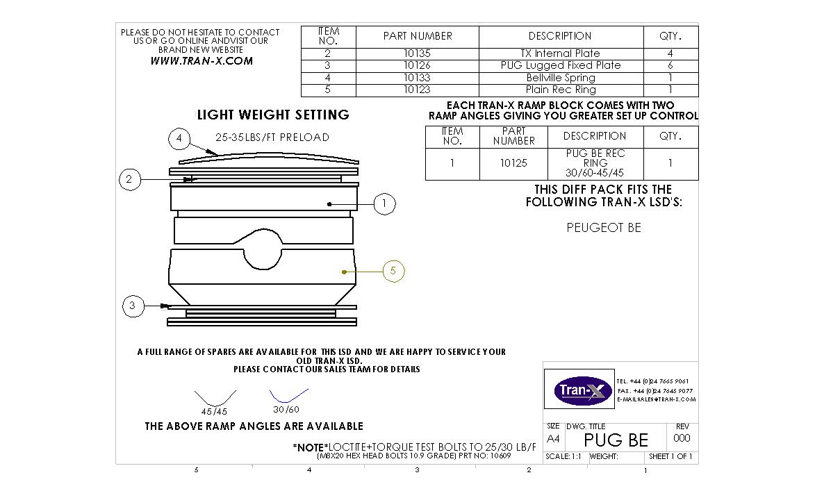

philfingers
Sorry Jon, didn't see your first reply
So the preload depends on the way the plates are arranged.
See the pics attached. Basically you have two types of plate, 'TX internal plate'(FRI) and a 'PUG fixed lug plate' (LUG), or in simpler terms the two are like the friction plate and cover in a std clutch.
Fully interleaved is LUG, FRI, LUG, FRI, LUG (NEAR SIDE) AND LUG, FRI, LUG, FRI, LUG (OFF SIDE). In this case you have a FRI/LUG interface 8 times
lightweight is LUG, LUG, FRI, FRI, LUG (NEAR SIDE) AND LUG, LUG, FRI, FRI, LUG (OFFSIDE). In this case the FRI/LUG interface is 4 times.
Each of these Friction/Lug interfaces has a set preload of around 6-7 lbft.
you already have all the parts to change between lightweight and fully interleaved, you just need to arrange them in a different order. The same with ramp angles, they come with 45/45 and 30/60, you just have to change some parts around. So you have four different setup options between the ramps and preload.
So when you order one if you don't like it, whip it out and change it. Which is a damn site easier in a BE box than an MA!
I have attached the files TranX sent me, I'm sure they won't mind

Phil, awesome answer. Thanks for helping a low poster!
Thats exactly what I was hoping they were like. I'm going to go for 45/45 and lightweight to start with as its on slicks so it just needs a smaller helping hand in getting grip. Without PAS I think the fully interleaved could end up wrenching the wheel out of my hands. I'm a weedy f**ker. ;)
