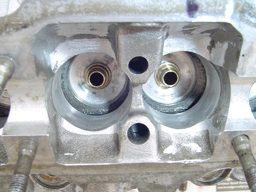

It requires a fair bit of material removal from the head to clear, the spray rail needs to be modified to clear and clamping it down on installation is tricky.

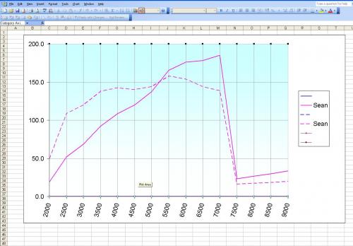

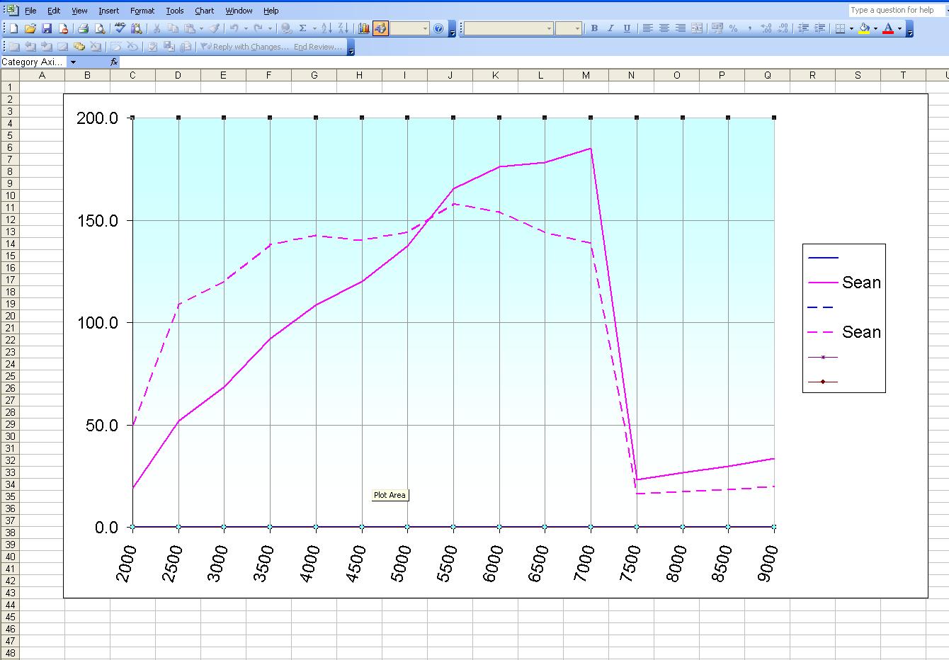

Peak power was capped by the tailpipe that was already fitted (1.6" ID), as you can see from the graph but never the less:
edbar
Torque is the dotted line? Looks like i hoped it would, Surprised there is so much grunt so soon! I take it the exhaust is critical then, so any suggestions for the manifold and system? Also wouldn't the design of manifold affect how soon the engine"comes on cam"? Thanks for the help. :P
Sandy
And it drives exactly like that. It's how things work out when it all comes together as it should. There'll be more peak power when the tailpipe's properly sorted out. There was still a few details on the engine I'd like to have improved, but the remit was to make what was already there work to give a good usable and friendly spread of grunt. The cam was exactly the sort of profile I wanted when I measured the lift curve. The exhaust manifold could be improved to flatten the slight dip from 4000-5500rpm given more development; but you're right on about how important the manifold is to the package. The inlet is equally critical and featured twin injectors staged on duty, which helps general behaviour no end. The head was Longman ported originally, but Mark Shillaber made some slight changes we felt would optimise it for this application and Mark's work is amongst the best in the business IMO if you want a good spread of power and top notch responsiveness.

So ill have to take the springs out, dummy fit the cam and rotate it, and die grind out any high spots is that correct?
That's right.
