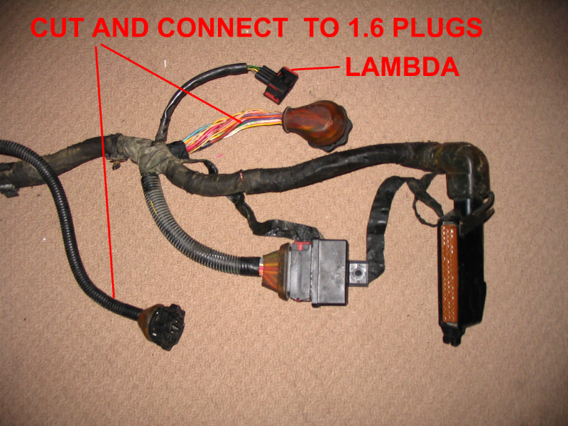

Xsara Loom, lose the round plugs and use the 205 plugs
Is the small spade connector in this pic a ground or a feed?
