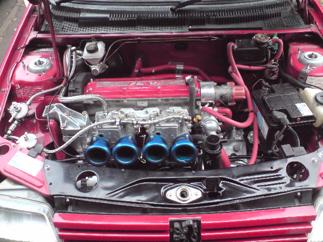

hexhamstu 9 Posted December 6, 2008 so its on mi16 management and carbs, but it smokes like james dean. havent solved the drive shaft as some ebay idiot sent me the wrong one. here is a video link of said smoke, any ideas? video of smokey smokerson. heres a picture of the drive shaft, hopefully getting a s16/gti-6 drive shaft should solve this. and here is the stupid car looking sorry for itself. on a plus note i blagged the halfords trade card! Share this post Link to post Share on other sites

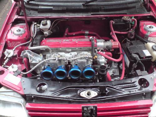

hexhamstu 9 Posted December 6, 2008 (edited) oh yeah, and the bonnet no longer shuts, anyone one with carbs solved this by cutting out all the extra bit under the bonnet just leaving the actually top skin if you know what i mean. really cant be arsed faffing on getting an auto bonnet sprayed to match. heres another photo........ Edited December 6, 2008 by hexhamstu Share this post Link to post Share on other sites

Miles 331 1 Cars Posted December 6, 2008 Need a new linkage that fit's under the carb's, you can just see it in this picture Share this post Link to post Share on other sites

welshpug 1,675 Posted December 8, 2008 how long has it sat idle for and has it had a long run yet? looks like just condensation to me Share this post Link to post Share on other sites
hexhamstu 9 Posted December 8, 2008 i was hoping you would say that! there is no sign of exhaust gasses in the expansion tank, so i dont think its head gasket. i think i'll just stick a drive shaft in and drive it a few miles. hopefully all will be fine. Share this post Link to post Share on other sites
DrSarty 99 1 Cars Posted December 8, 2008 i was hoping you would say that! there is no sign of exhaust gasses in the expansion tank, so i dont think its head gasket. i think i'll just stick a drive shaft in and drive it a few miles. hopefully all will be fine. I think that's the plan. What about jetting? Once she's warm and done a few miles, you could check the plugs to see how it's burning. It may be running rich depending on what you did with the jets and also the ambient temp and humidity will effect what the smoke looks like out the back. Have a blat and I reckon it'll go away and make you a happy chappy again. Share this post Link to post Share on other sites
hexhamstu 9 Posted December 8, 2008 as far as i know the mechanic didnt touch the jets as it was already jetted for the engine and ran fine in stuFs car. going back home on the 18th so will be doing the driveshaft then just need to buy another! also what is the MOT requirements about the bonnet? can i get through it without one? i guess i just need to fine an auto bonnet for the time being. Share this post Link to post Share on other sites
welshpug 1,675 Posted December 8, 2008 do bear in mind that the bulge on an auto bonnet is at the back not the front... Share this post Link to post Share on other sites
hexhamstu 9 Posted December 8, 2008 do bear in mind that the bulge on an auto bonnet is at the back not the front... so basically isnt going to help? i think a foam filter is going to be needed. Share this post Link to post Share on other sites

Baz 421 Posted December 9, 2008 Auto bonnet will help a little as there's still more clearance due to the less strengthening bars on the underside being in a different place. Share this post Link to post Share on other sites
mattbenselin 0 Posted December 9, 2008 I have an auto bonnet in the garage which has had the bit underneath cut away to accomodate K&N filters such as yours. So I'm guessing even the auto bonnet doesn't clear them, as said before probably because the bulge is further back. You could try an ITG filter or similar or try to lower yours; do they removable base plates? Yes or no you could try make a new base plate with the holes closer to the top and attach them to the back of your filters, then the filters would sit lower in relation to the carbs and bonnet. Matt Share this post Link to post Share on other sites
hexhamstu 9 Posted December 9, 2008 I have an auto bonnet in the garage which has had the bit underneath cut away to accomodate K&N filters such as yours. So I'm guessing even the auto bonnet doesn't clear them, as said before probably because the bulge is further back.You could try an ITG filter or similar or try to lower yours; do they removable base plates? Yes or no you could try make a new base plate with the holes closer to the top and attach them to the back of your filters, then the filters would sit lower in relation to the carbs and bonnet. Matt i like the new back plate idea, i'll try that one out. Share this post Link to post Share on other sites

Martin W 0 Posted December 12, 2008 I just use a pair of foam ITG filters, the bonnet squashes the top of them every so slightly on the underside strengthening and the bonnet closes fine. Thats a chaper alternative. Share this post Link to post Share on other sites
hexhamstu 9 Posted December 12, 2008 just bought the 2 ITG ones. hopefully someone will buy my K+N ones on ebay. Share this post Link to post Share on other sites
