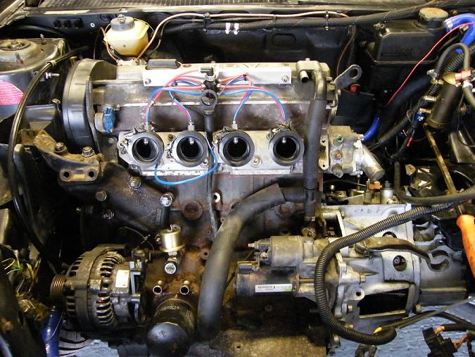

pip470 61 Posted January 8, 2009 Had a great day with the pug today and I even remembered to take some pics so heres an update. Ive been trying to sort out all the little jobs like filling the gearbox oil, fitting new clutch cable, mounting the fuel pump in the engine bay on the old ignition coil mounts. Not sure if the pump will work in this position but I have seen a couple in a similar oreintation but near the fuel filter, only time will tell. Ive also mounted the nitrous bottle in the boot and removed all the seats to run the fuel line under the carpet. Gave it a good hoover too whilst its all out. There is still a long way to go before its ready for a rolling road session and mot but I have a week of in feb just after payday so I'm planning on getting it prety much completed ready for an mot tax insurance in march. That should give plenty of road time before the road trip to sort out the niggles. I'm finding this car much harder to build than the drag car as things have to be a lot tidyer and fitting everything in with all the standard gear takes a lot longer. I will carry on regardless though and hope fully build a nice road car. So heres some pics of the garage and car and things. Cheers Phill This was not the final pic of the modified standard fuel pump. I used the housing to make a pick up pipe but in this pic the pick up pipe is too long, The bottom of the tank seems to actually only be the legnth of the fuel pump body. http://i207.photobucket.com/albums/bb271/p...ld/DSCF1809.jpg The fuel line under the passenger. http://i207.photobucket.com/albums/bb271/p...ld/DSCF1818.jpg The fuel pump mounted in the engine bay. http://i207.photobucket.com/albums/bb271/p...ld/DSCF1811.jpg The nitrous bottle mounted. http://i207.photobucket.com/albums/bb271/p...ld/DSCF1848.jpg The tasty carbon fibre spark plug cover. http://i207.photobucket.com/albums/bb271/p...ld/DSCF1841.jpg http://i207.photobucket.com/albums/bb271/p...ld/DSCF1827.jpg http://i207.photobucket.com/albums/bb271/p...ld/DSCF1828.jpg The ignition managment mounted in the drivers foot well http://i207.photobucket.com/albums/bb271/p...ld/DSCF1830.jpg http://i207.photobucket.com/albums/bb271/p...ld/DSCF1831.jpg My new garage http://i207.photobucket.com/albums/bb271/p...ld/DSCF1837.jpg http://i207.photobucket.com/albums/bb271/p...ld/DSCF1842.jpg Thats all for now really, I need to start buying a few things no but until payday comes its just carrying on with the fidley jobs. Thanks for looking. Share this post Link to post Share on other sites

pip470 61 Posted February 16, 2009 It would be rude not to go to the pod this year dave, would really like to see this lancia you got too. Thanks para, Looking forward to meeting you on the Euro trip. So on with the update, Brakes. I have gone for a pair of 278mm two piece disks and a pair of pro race 3 4 pot calipers from comp brake on the front, The rear has just been replaced with new stuff and the claiper yokes painted to match the front. New disk's, pads, calipers and braided hoses. I have fitted a new ali peugeot 406 non abs 23.8 mastercylinder and also by mistake a 235mm servo as i broke mine trying to adjust the rod in the center. I had to bash a little on the scuttle area and also virtually dismantle all the work I had done fitting the engine so that the engine could be lifted forward to allow the servo to squeze past the head. It was very tight but after I scratched my cam covers to hell it went in. All the brakes have now been bled and all thats left to do is run a servo pipe to the take off ive had rewelded on the manifold. I was going to go for an electric servo pump but it worked out way more than I could afford. I know these brakes are well overspecced for the car but I have two points really. One is when the car is somewhere demanding like the stelvio pass, I dont want brake fade to be a reason not to enjoy driving it. Especially if I have the chance to do something about it. The other is I have an unhealthy obbsesion for buying shineys for my car, I dont drink every weekend or smoke so i have to waste my money on something but unlike the other two mentioned these might actually save my life. The car is waiting for some niggly things now thats holding the build up, mainly the cambelt cover, whilst the engine is hoisted to clear the servo it seems the best time to try and fit a cover, I tried my gti-6 one and its different (no suprise) so If you have one please get in touch. I can then get all the engine conected up and the wheels on as its depressing when its on axel stands. Im pushing hard for an MOT at the end of feb and also the rolling road tune up, If theres no problems then I may make it my full time untill after the Euro trip as my van is slowly dying. Enough wabble, heres some pics I hope. Share this post Link to post Share on other sites
