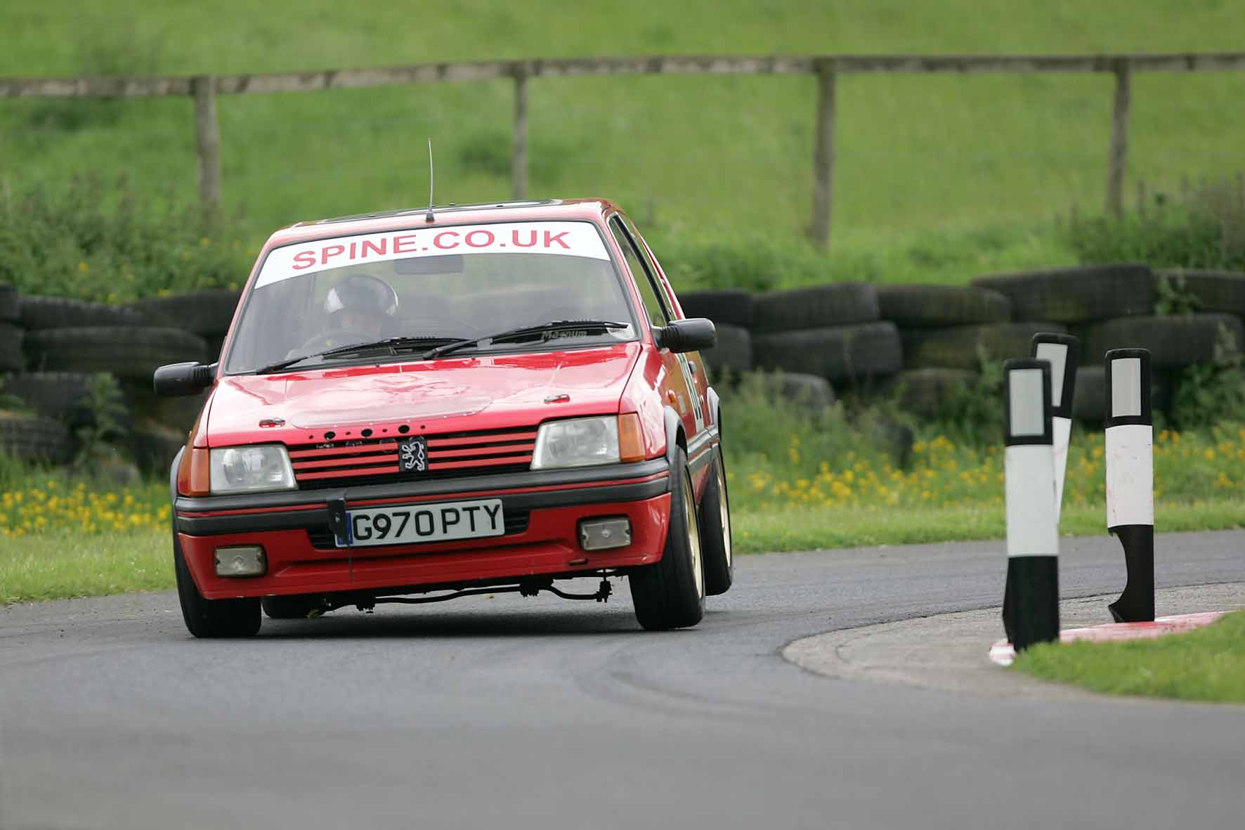

For rally etc I think clearance will be a big issue
See how much mine hung down at the drop links when we underslung the arb :blink:
you wouldn't be able to bolt it underneath due to the sump guard on a rally car (IIRC all the designs I've seen attach rearwards of the ARB)
just a thought, and I haven't looked at my car so I may be wide of the mark here, but would using a shorter droplink raise the ARB sufficiently to clear the wishbone?
AFAIK the only part this would cause issues with would be the track rods, the driveshafts I think are far enough forward of the ARB not to cause any problems.

Jeeeeez that's low! Have you actually bolted the whole thing to the underside there?
I was planning on having it in the standard position and have a short drop-link coming from that little boss on the front arm, so it would be quite close to the bottom of the wishbone. I'm hoping that it should move upwards at about the same rate as the wishbone so there shouldn't be any issues with interference. I'm working on a model of the whole assembly now so should be able to find the best way to make it fit without having to make a load of prototypes.
I don't know weather raising it will help, you might have to raise it by quite a lot to get it to clear.
