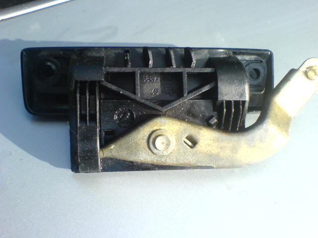

Yeah, needless to say it's seized again. Time to take the handle off.

Yep. It's fiddly job, in particular getting it back in and reconnecting the rods.
You need to WD40 the long spring on the back of the handle itself, and exercise it A LOT to satisfy yourself it will spring back by itself.
Good luck, and don't get angry. Walk away and return if it starts to irritate you.

the gold coloured bugger's the culprit, WD it and work until it springs back all the way on it's own

got the handle back in, now just to connect the rod back up arrgh!
