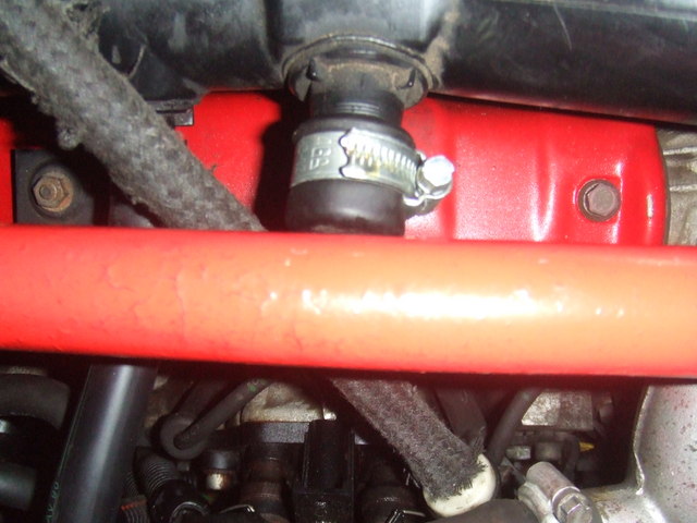

If you have an alloy pipe that goes from the back of the engine to the front, it fit's on there, it might have a recirc valve fitted already, in which case you will need to remove it, if it's a plastic pipe that goes from the back to the front then you will have 2 take-offs to choose from, both close together, about level with the throttle body IIRC
sonofsam

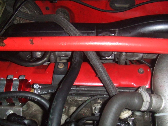

It can go on the cross-over pipe:
The smaller pipe can go to the spare nipple on the side of the manifold.

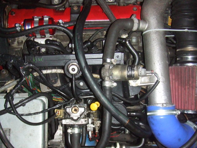

My chav valve is fitted where your electrical thingy is (ICV). My ICV is tapped into the intercooler though. Could you try and tee your ICV into your air filter pipe work? looks close enough to do..
Edited by craig f90
m_attt
could i move the icv to the blanked of bit on the back plastic pipe?
Rob Turbo
Nope, that's the intake pipe and would cause a boost leak if you fitted the ICV there, and the dump valve would do nothing if you fitted it there, you're going to have to get a T piece put in one of your boost pipes to fit a dump valve.
