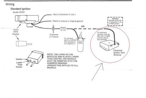

I have recently brought a shift light for my rally car
I am struggling to work out which wire to use on the coil pack side
Please find the wiring diagram below
The suspect wiring is circled with arrow
Thanks

Which engine/car is it?
If its a 205 GTI with the original coil the bit you circled doesn't apply, just connect it to the coil. If its a newer setup with coilpacks it needs to be connected to the tachometer output from the ECU.

sorry its a 205 gti 1.6
but i am running carbs therefore i am not running an ecu
i have the wiring to the amplifier and to the coil pack
this is why i am confused, origionally i thought the coil pack wouldnt work without the ecu, but it does
any help would be good
thank
ian
jackherer
Just connect the shift light to the negative (-) pin on your coil, ignore the dashed line on that diagram, that is for much newer cars with coilpacks not coils, it means they have more than one coil basically.
If your 205 is post 1990 or thereabouts it might not have a cylindrical coil like the one in the diagram, it might be a squarer unit that would have been mounted on the inlet manifold if you didn't have carbs, if so its still wired the same, you will see a - by the correct pin.

thanks for you help i will give it a try
