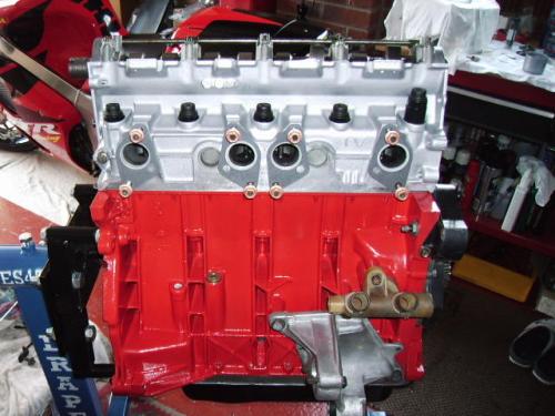

Veero
Why would it need to be higher than 150*c? If the block's getting that hot something must be wrong. I used hamemrite on my Mi block:
Been good for 2 years and 10,000 miles even with a leaky oil pressure sensor.

well its been a while... but its done with the ally colour from frost motor sport .
before
after
what do you rekon then ?
i'd of prefered a finish like atari boys but its obviousley different paint. ....
better than before though
johny
Edited by johny105_y2k
pete1986
Looks good mate. I wish i did mine now, simply couldnt be arsed when the time came. Ahh bugger!

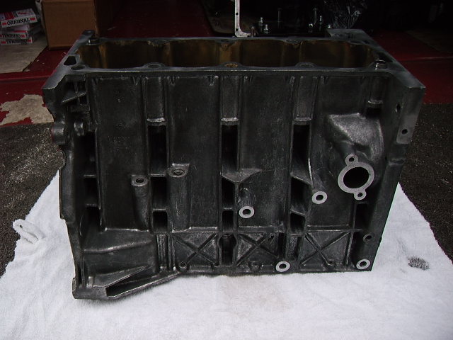

jord294
good old hammerite :)
from this
to this
