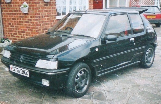

my 1st car had them i jsut used self tappers, they didnt fall off.
my 205 xs many moons ago, check the spoiler haha
