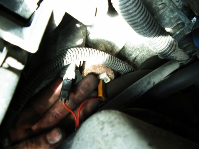

RINRIN 1 Posted September 14, 2008 Hi, I cleaned the throttle and afterward I realized that oil pressure in the dash is not working. I start to investigate the sensor and in front of engine under inlet manifold I saw an unpluged connector. I guess it is the pressure sensor but there should it be connected Share this post Link to post Share on other sites
carbers205 1 Posted September 14, 2008 It looks a lot like it mate, quite a big white sensor. Has a connector with only one wire as far as I remember Share this post Link to post Share on other sites
RINRIN 1 Posted September 15, 2008 It looks a lot like it mate, quite a big white sensor.Has a connector with only one wire as far as I remember thanks bro in the picture there is a orange 1 wired connector screwdriver holds its wire and it is not pluged. Also there is a white connector and it is connected with a one wired connector. So where should be the orange connector. Share this post Link to post Share on other sites
Grim.Badger 15 Posted September 15, 2008 The oil pressure sender that activates the warning light should be connected to the orange wire. The oil pressure sensore that activates the guage should have a grey wire. Share this post Link to post Share on other sites
RINRIN 1 Posted September 15, 2008 I have the oil pressure warning light before starting the engine but when I start the engine there is no oil pressure Where should it be connected any pic or any guide? Share this post Link to post Share on other sites
CosKev 16 Posted September 15, 2008 Heres a pic that you can see both sensors on. The large white sensor on the right as you look at engine is oil pressure gauge,the smaller black and green one on the left is the oil pressure warning light sensor Share this post Link to post Share on other sites
RINRIN 1 Posted September 15, 2008 Thanks bro, magnificent I check immediately Share this post Link to post Share on other sites
welshpug 1,666 Posted September 15, 2008 here's a picture including the wires - Share this post Link to post Share on other sites
RINRIN 1 Posted September 16, 2008 Thanks mate, this will cover everything. Today after work I will check it. Share this post Link to post Share on other sites
