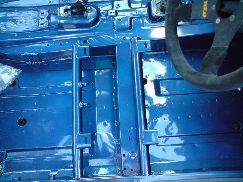

This is how at least I would mount any seat's
