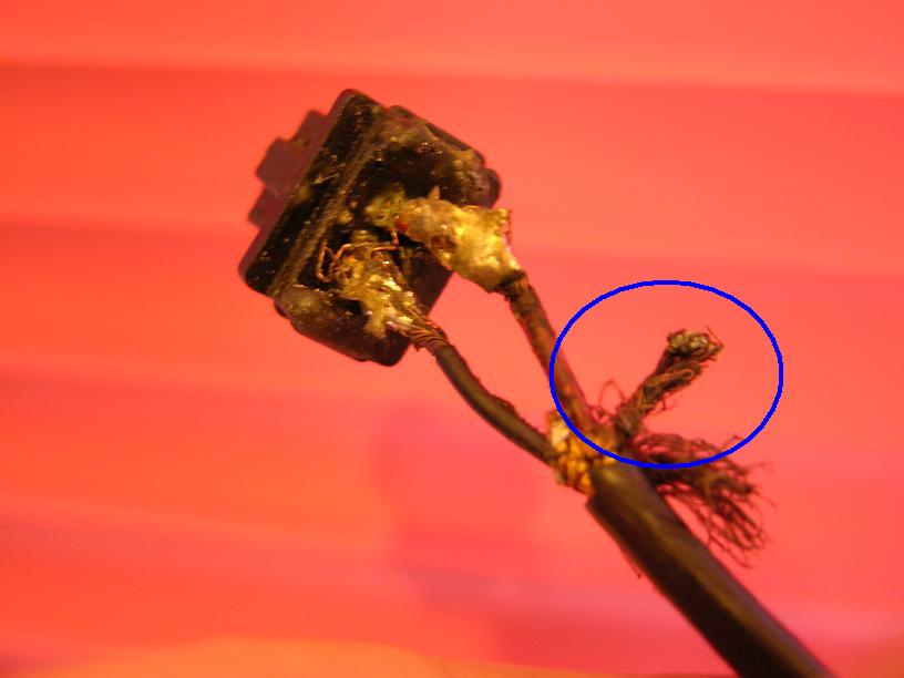

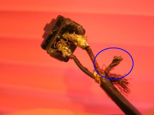

mercury 0 Posted September 1, 2008 (edited) Hey guys, does anyone have a pic of the early 1.9 wire or 1.6 wire that connects to the dizzy (i believe they are the same), so i can look at if there is an eyelet or 3rd wire that connects to the dizzy. Ive recently fixed my wire but dont know what to do with this braided wire around it... when i took it off it was just hanging on the side. Someone suggested that it could have had an eyelet that connected to the dizzy somehow? Anyone got any ideas? Cheers, Merc Edited September 1, 2008 by mercury Share this post Link to post Share on other sites
welshpug 1,666 Posted September 1, 2008 its a shield wire which only needs to be connected at one end, which it is if its plugged in Share this post Link to post Share on other sites
mercury 0 Posted September 1, 2008 its a shield wire which only needs to be connected at one end, which it is if its plugged in so it will be connected once i connect the whole blastic bit tot he dizzy? Or do i have to connect it to somewhere? Can i trim it so that it doesnt hang out? Cheers, Merc Share this post Link to post Share on other sites
welshpug 1,666 Posted September 1, 2008 no, it'll be connected when you plug the 3 pin connector in at the other end. I would either tape it up with insulation tape or shrink-wrap it if possible. Share this post Link to post Share on other sites
mercury 0 Posted September 1, 2008 (edited) no, it'll be connected when you plug the 3 pin connector in at the other end. I would either tape it up with insulation tape or shrink-wrap it if possible. OH YEH! the other end has 3 pins lol. ok now i get it. thank you so much welshpug. Merc edit: would it be ok to cut it then or doe sit need to stay long and wrap it to the side? Edited September 1, 2008 by mercury Share this post Link to post Share on other sites
Cameron 16 Posted September 1, 2008 I'd just cut it off, it's not doing anything at that end. Share this post Link to post Share on other sites
