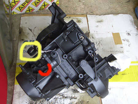

Turbloide2 0 Posted August 29, 2008 Ive just put the engine and gear box in its a 1.6 BE3 gear box so were does the square plastic part go ? cant seam to see anywere neaar the release arm..... Has any one got any pic of the clutch cable set up up on the BE3 gearbox ? thanks Share this post Link to post Share on other sites
pug_ham 245 3 Cars Posted August 31, 2008 The square part fits into the gearbox casing & you should have another round part the fits into the clutch cable end lever on the gearbox. See attached image. Red U is for the cable outer end stop (square-ish) & yellow is where the actual cable end with the round plastic plug, 13mm & 10mm adjusting nuts on the threaded end fit. Graham. Share this post Link to post Share on other sites
