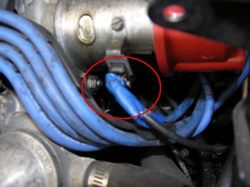

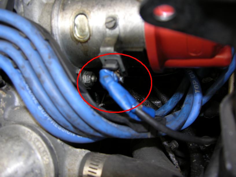

oh you mean this thing?

That's the fella, though mine (and all the others I've seen) look different to that. The first picture in the other thread has a picture of the connector. Maybe they make them differently in Oz.
