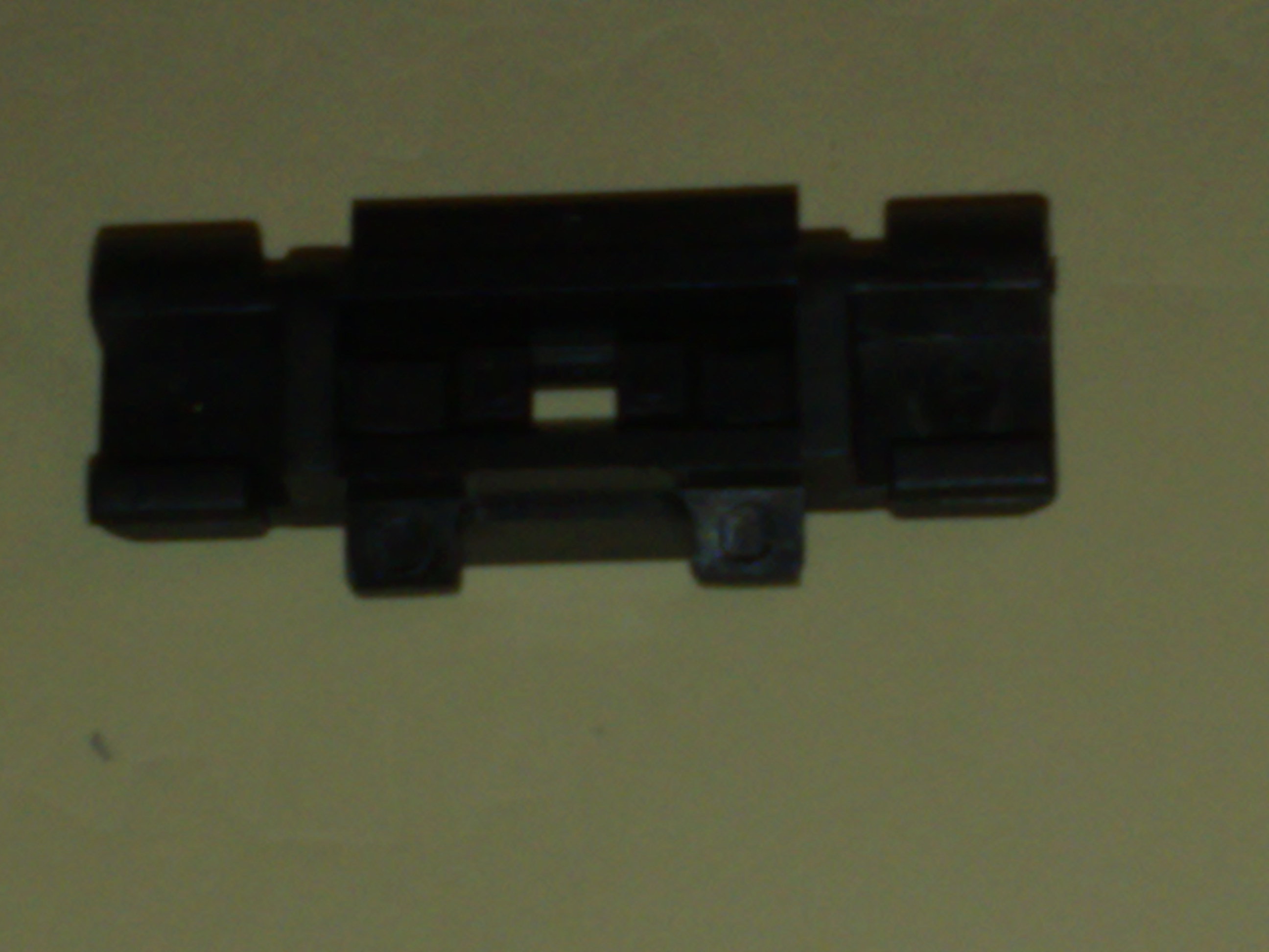

Anyway, my problem is this... the bumper clips look like this...
The red insert attaches easily. But i dont see how the other side fit to the bumper? There must be something missing
When i removed the old clips they were round with a square(ish) head but these ones are totally different.
Also the new bumper does not have any holes in it, apart from the rectangular recesses. Maybe thats why it was £25 less!
those aren't for the bumper, they slide into the red trim and clip over the rivets on the door trim and rear 1/4 panel.
does the bumper have holes at the ends for the arch trims to clip to?

thats correct you have been given side clips and you need front bumper clips. also you need to drill your own holes, thats normal
Yep, wrong clips.
The bumper ones have a flat rectangular face that slides in to the red trim, and on the back it just has a stub with a bulged end (I suppose you could compare it to a miniature cock, if you want to visualise it ;) ) which just presses in to the hole in the bumper.

Ok, so that means Autofive have totally neglected sending me any bumper clips! Ill get on the phone to them (again!) tommorrow. Which reminds me actually, i got my phone bill through yesterday and noticed that what looked like a mobile number was costing me 50p a min. I soon twigged that it was autofive, ending in 205 GTI (484). Cheeky buggers!
Welshpug - Yeh it has the two holes for the arches so its definately a GTi one, i pressume thats why you were asking.
Glad its normal to not have holes in the bumper, i thought they had given me the wrong one as well! ;) Still, wonder why he gave a discount like that, this is Peugeot who charge £310 for a pair of wishbones?!?!
