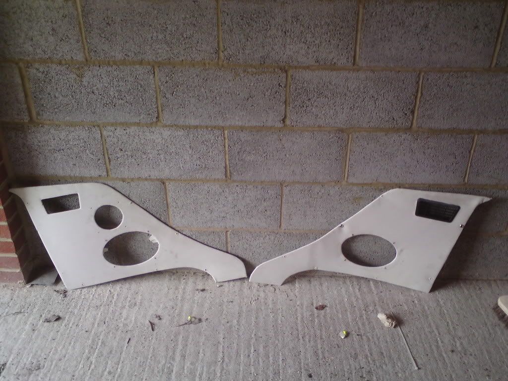

I've got some rear panels for sale that are already built to take a pair of 6x9s and fit into the rear side panels.
http://forum.205gtidrivers.com/index.php?showtopic=92838
These worked fine before I removed from the car (trackcar so took most of the stereo out). If you're after really good sound then I would reinforce these with another layer of wood, but it'd be easily done using these as a template.
Sorry for the blatant plug, but it does give you a different option for mounting.. you don't always need to have them in a parcel shelf!
