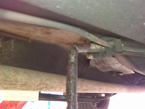

I had an advisory on mine and had intended to change them. I bit the bullet yesterday and with the car up on the ramp, pulled one out of the clip and it instantly sprung a leak:

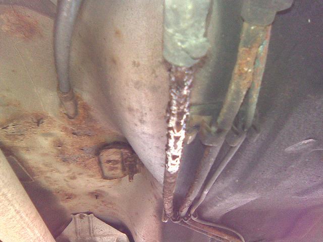

The other one snapped in half as soon as I tried to unclip it:
I'm very very glad I did them now! I replaced mine with 8mm copper gas pipe.
