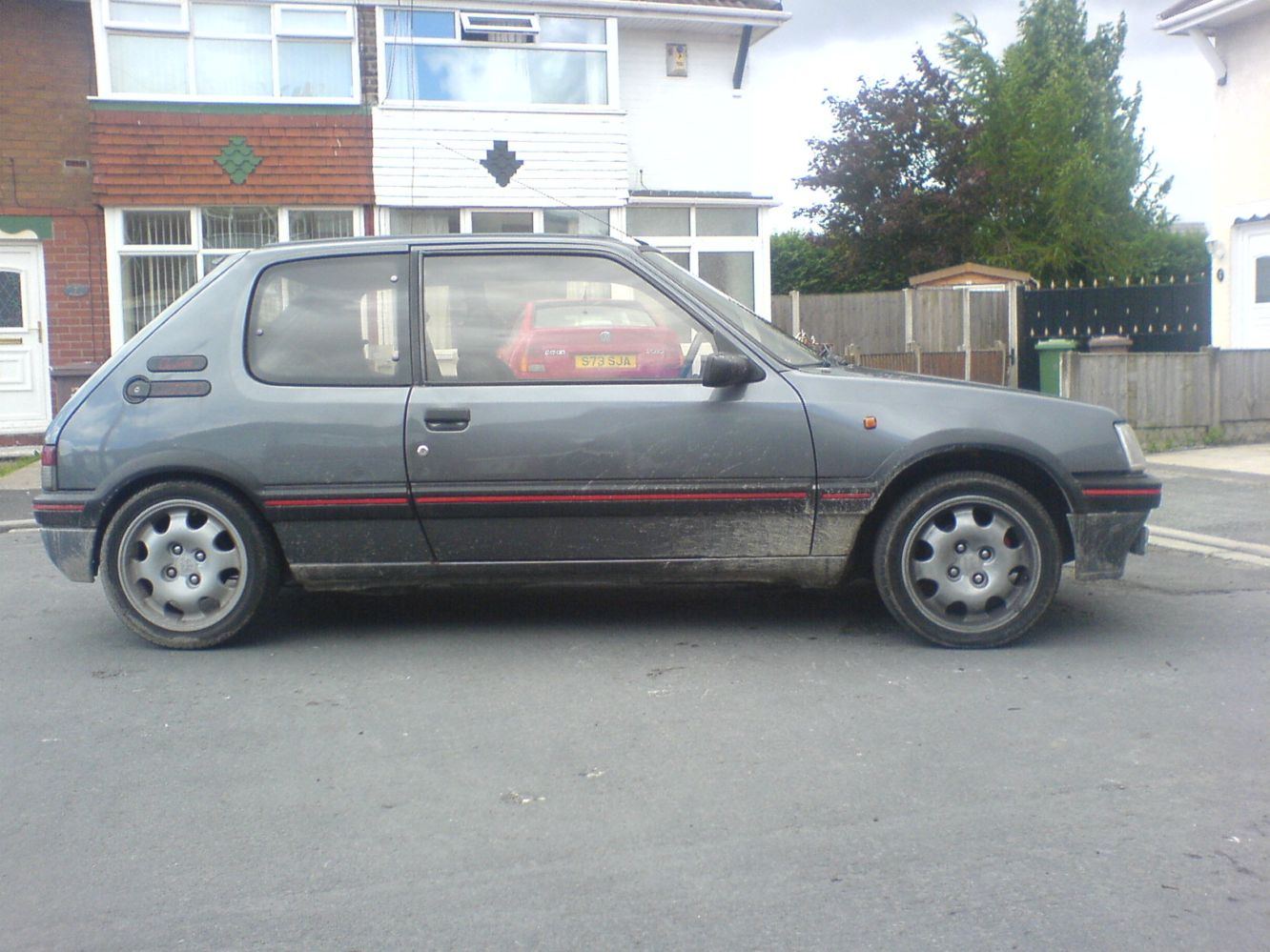

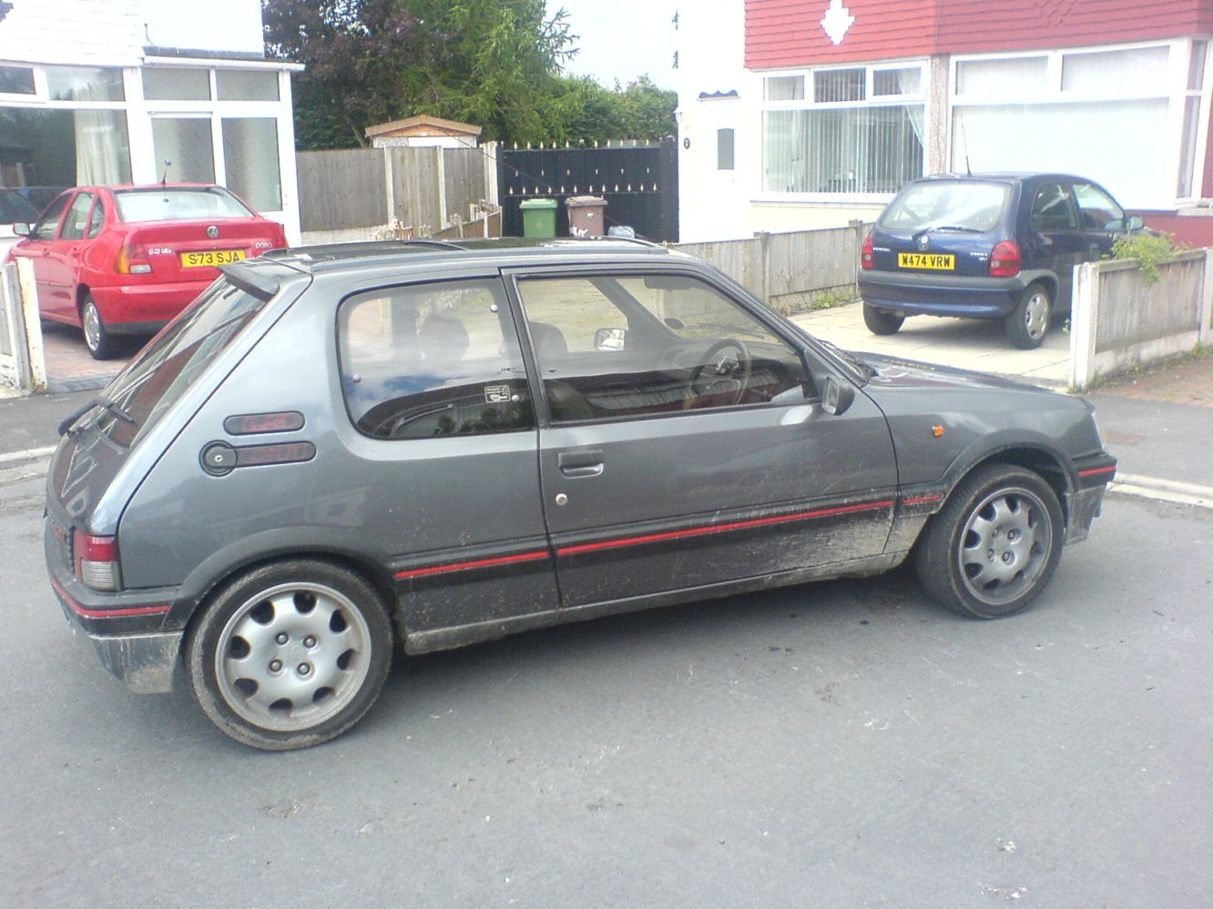

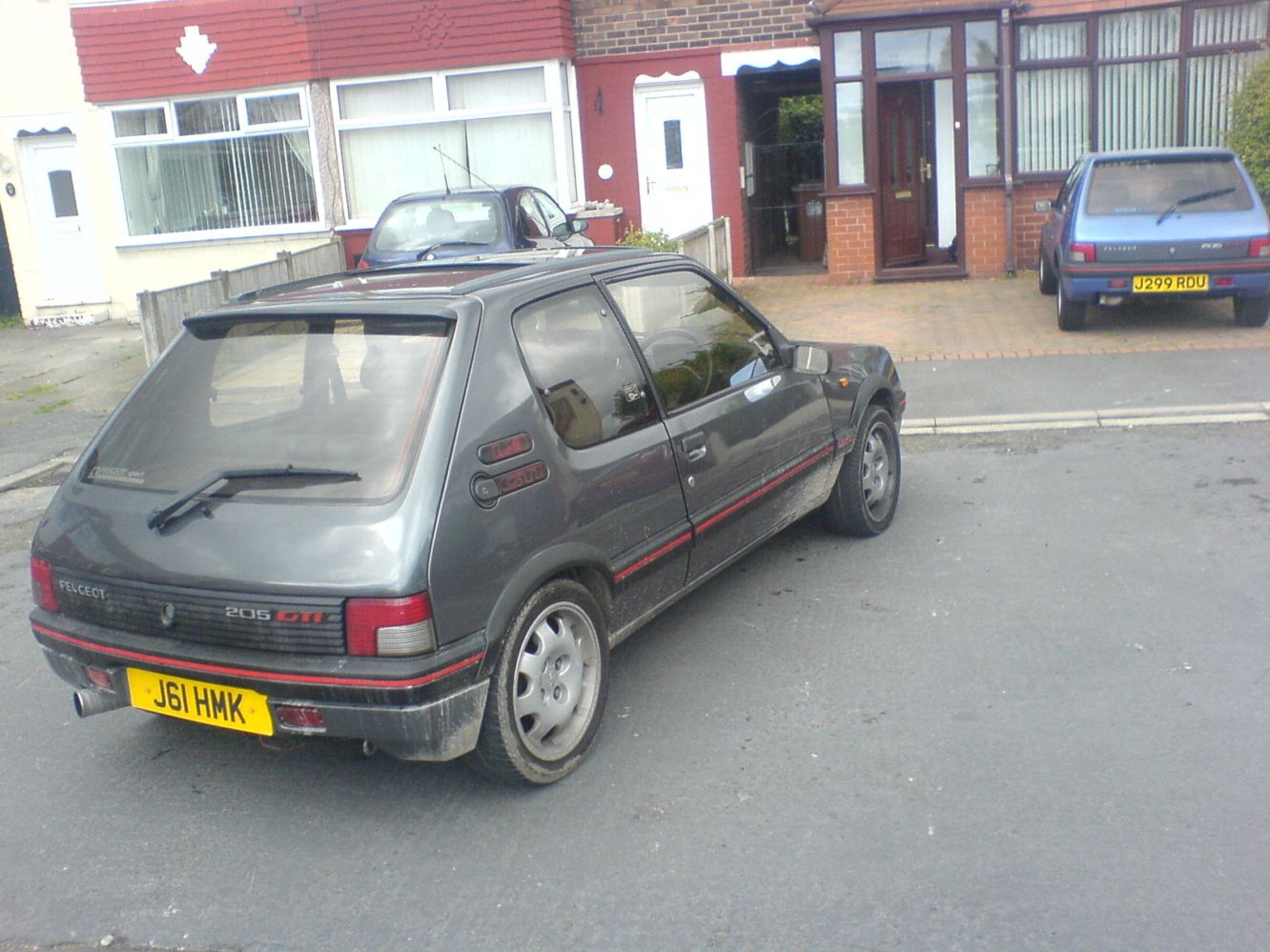

Hi,
I've put some standard front springs back on my 205 (it previously had some 50-60mm drop springs on the front)
I have not touched the back, and need some opinions if it looks like it needs raising. I think it needs raising a little.
What do you think?

I would definitely raise it - (or take Rik Waller out of the boot) :blink: Just put mine back to standard and IMO much better drive for a road car.- I am an old softy, though

I noticed the difference instantly when putting the front springs back on. So more refined on our B roads. Peugeot got it right 1st time. The beam looks like its in good condition so hopefully it wont fall to bits when i raise it.

Yep, get the back up a little
gti-si
Get that back raised up a spline or maybe even two I'd say

I've not touched a rear beam before. Will i need one of those reverseable hammers used in that episode of Wheeler Dealers to remove the torsion bar?
It needs raising a little.
Don't use the spline method, its a bodge method & you risk killing the rear beam doing it.
If you are at all unsure about the condition of your beam you might as well give it a full refurb & then you can set the torsion bars free at both ends & set the rear ride height to anything you want.
