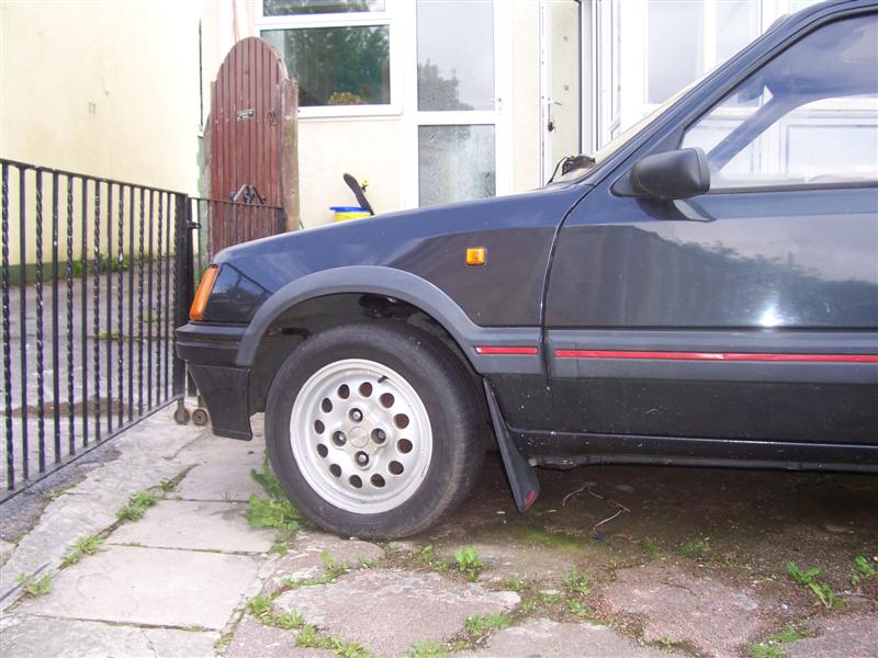

Can anyone confirm the poundage/spring rate (I can probably get this from PLR if needs be) and the ride height that they sit at compared to standard, ideally with a picture?

I have a set of PeterL gravel spec springs on my pug with sprintline front shocks and they are at standard ride height at 160Lbs. The tarmac springs are 190-195Lbs, slightly lowered but dont know by how much.
