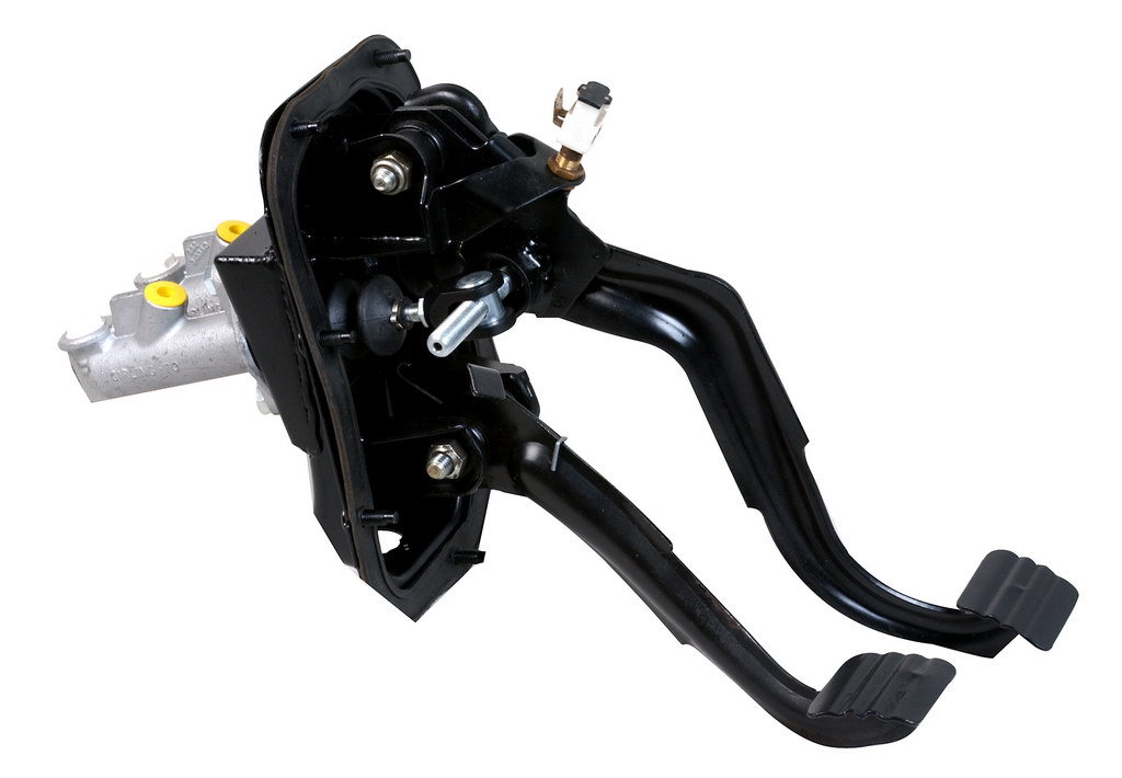

cybernck 403 1 Cars Posted July 5, 2008 with your user level, you'll have to upload it to photobucket or some place like that i'm afraid. here's a pic of the MW Motorsport 205 pedal box - quite nice but not what i'm looking for. i'm waiting to hear if they can supply one that would suit my needs. where else can i get one though... thinking Rally Design? Share this post Link to post Share on other sites
jerseypug 1 Posted July 6, 2008 i have just ordered one from compbrake.co.uk the guy who makes them used to work for gartrack and supplies quality parts. he takes your old pedal box and converts it, it might be worth talking to him and see if hecan sort out what you need. Share this post Link to post Share on other sites

welshpug 1,676 Posted July 18, 2008 can't remember where I found this picture but here's a twin MC pedal box. http://image52.webshots.com/52/7/87/91/541...91UrDODk_fs.jpg (quite a large image!!) Share this post Link to post Share on other sites
