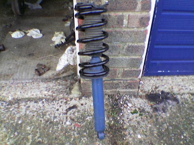

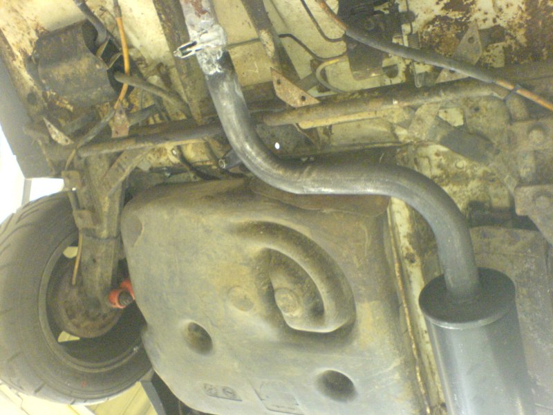

Seeing as Rich mentioned the Visa first I feel ok in posting a pic heh. Heres the underneath of mine, in a bit of a state in that photo. The coilovers are pretty much 1:1 ratio and go up as far as the parcel shelf so quite long. Rear Arb routes across bending above the exhaust. Fuel pump and filter are top left in that photo, rear brake compensator (split front/rear) is up top right, also attached photo of a rear shock. Will stop boring you now and let you get back to 205's :)
edit: photo of rear added. 205's ive seen with this sort of conversion done have box sections sticking up at each side of the boot (which is much bigger than the Visa's useless one!)
