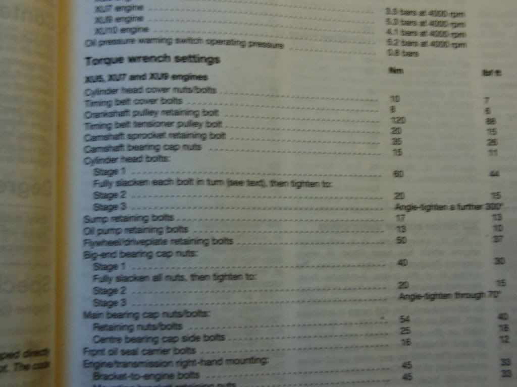

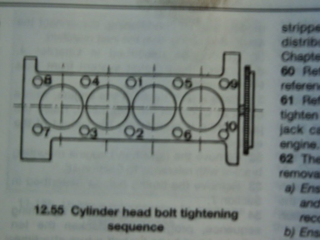

eob 7 Posted June 26, 2008 Did an exhaustive search to no avail (surprised at that) but I'm just looking for the bolt tightening sequence and the torque/degrees to turn settings for an all-alloy Mi16 (D6C). In particular I'm interested the Peugeot way (someone mentioned 300 degrees in one of the threads?) versus other peoples own methods (incrementally tightening it using torque settings). Share this post Link to post Share on other sites
James_m 0 Posted June 26, 2008 There was a thread on this subject a few months back so dont give up! which had some good information. I think the general concensus is that the Peugeot method is overkill, and a bit risky on 20 yr old aluminium blocks. Personally, i torqued mine to 75ibs ft maybe a little less on threads that felt a bit fragile and ive had no problems. I think the important part is that the head is flat, and the tightening sequence is adhered to. Share this post Link to post Share on other sites

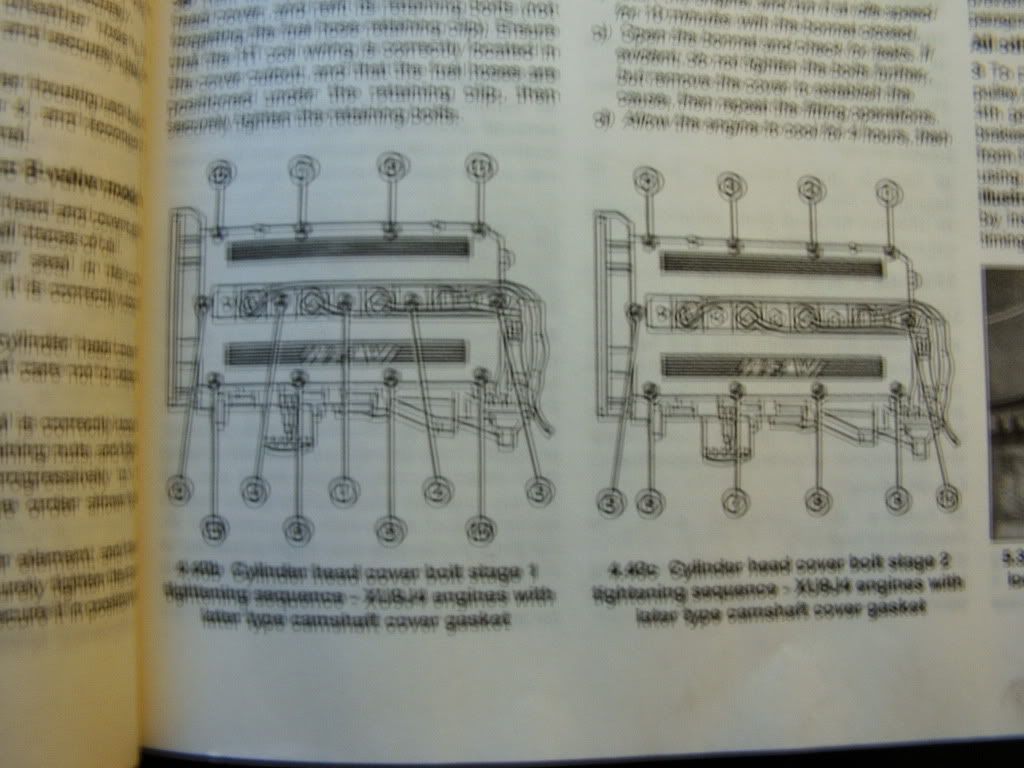

welshpug 1,666 Posted June 26, 2008 torque settings - http://i47.photobucket.com/albums/f169/wel...cs/PICT0013.jpg tightening sequence - http://i47.photobucket.com/albums/f169/wel.../PICT0015-1.jpg 1.9 cam cover tightening sequence - http://i47.photobucket.com/albums/f169/wel.../PICT0016-1.jpg there's also a special tightening sequence to the cam carriers Share this post Link to post Share on other sites
eob 7 Posted June 26, 2008 You guys are not just men but the men. How your better halves sleep at night without being overcome with fear of losing you is beyond me. I'm, err, downloading a 405 manual (rhymes with 'James') in order to get the tightening sequence for the cam carriers as I just nipped those up by hand. Those pictures are really going to help but I'm still interesting in hearing how other people do the tightening sequence. I think you're right on the whole Mi16 overkill on tightening thing as I spotted that in a few threads. Someone was suggesting 75lb/ft per head bolt, then tighten to 101lb/ft? Share this post Link to post Share on other sites
DamirGTI 344 Posted June 26, 2008 Im using this method , for both the 8v and 16v 1.9 engines : 1. stage - 30Nm 2. stage - 55Nm 3. stage - loosen each bolt 1/8th turn and re-tighten back to 55Nm 4. stage - 80Nm 5. stage - 95Nm (70lbf ft) More info here : http://forum.205gtidrivers.com/index.php?s...4&hl=torque http://forum.205gtidrivers.com/index.php?s...323&hl=head Rgs ! Damir Share this post Link to post Share on other sites
