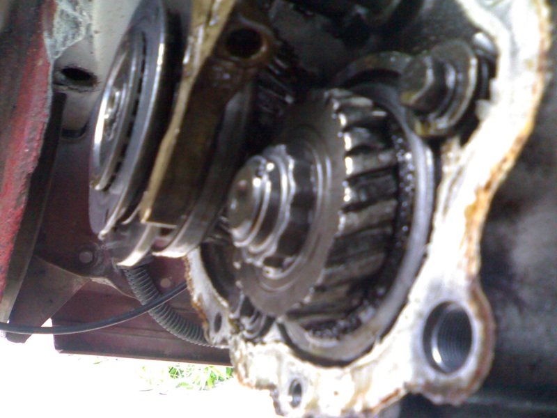

I just got back from London, didn't need breakdown cover :D
The rivets holding the hub on had come off, the cogs were stripped and the nut holding the gear on was very loose. I took all the debris out, topped off the oil and then drove it.
