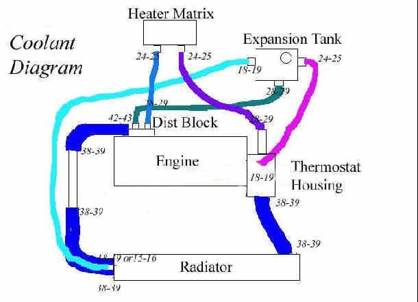

hi i am needing a new pipe that goes from the bottom of the lower expansion bottle. a local company will be making me some pipes up but i need the diameter to do a quick fix to get it on the road as it is my everyday driver.
cheers si
28-30mm each end.
Graham.
