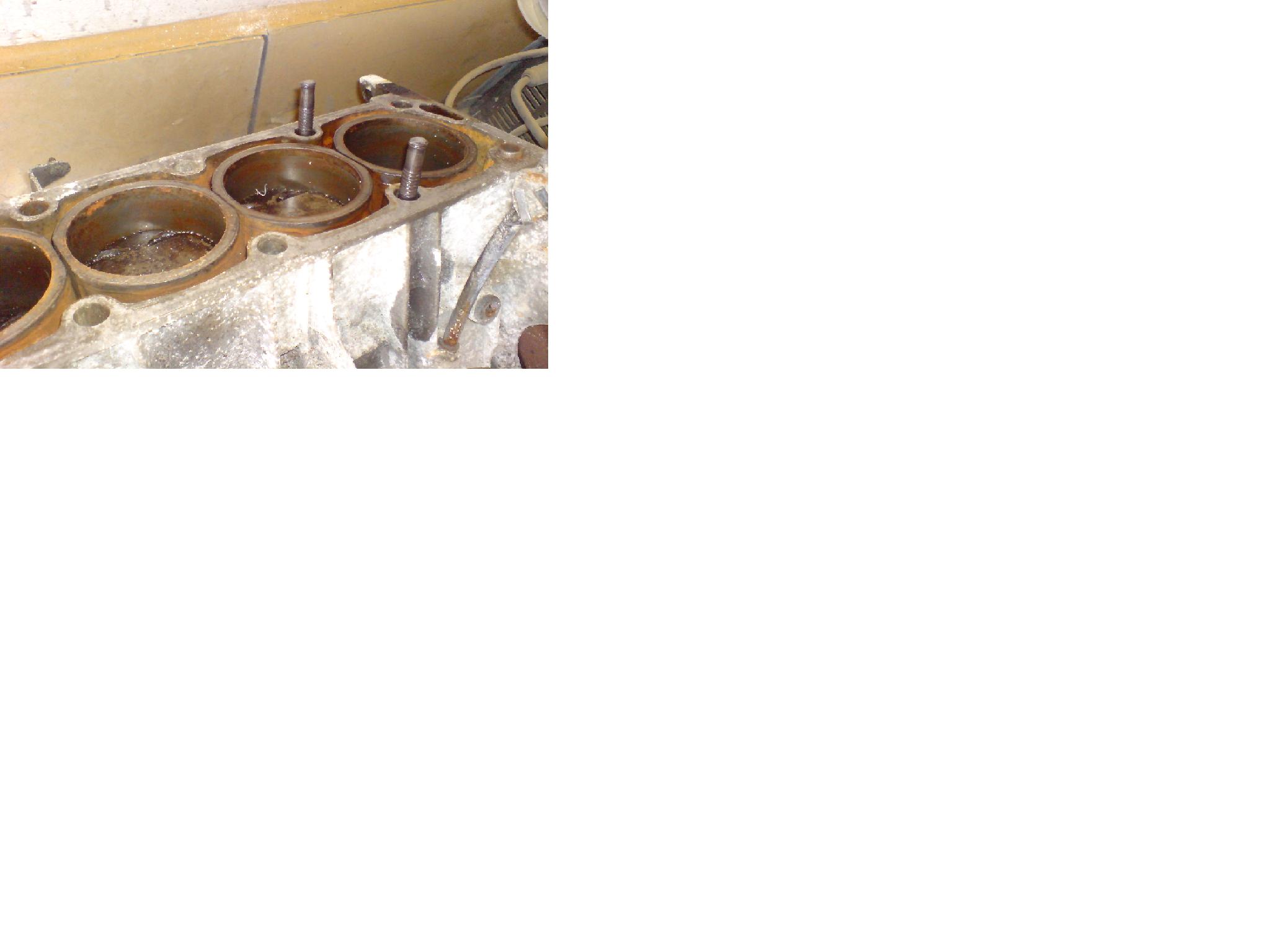

Pug_sport 0 Posted June 4, 2008 Look what i've done!! dam dam dam dam. They were a little bit tight in there holes. Hopefully they will come out with some heat. Share this post Link to post Share on other sites
Tom Fenton 1,576 Posted June 4, 2008 Quite common, at least you've got plenty sticking out to get hold of. I'd give them a soak down the threads with some diesel for a day or two before welding a nut to the top and trying to work them backwards and forwards to loosen off the corrosion and hopefully get them out. Share this post Link to post Share on other sites
