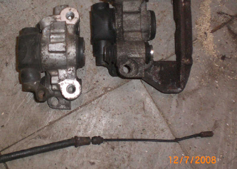

See below. Have I ruined the calliper? Hammer and punch did not work.......

Is trying to drill out bad? Is the hole in the calliper tapered?
this is what you're trying to remove;
should be fine to drill it out, gradually increase the size of the bit, just don't go too large and damage the caliper itself.
No, the hole in the caliper is straight but there is a different sized lip where the cable end sits in.
You can only hit the end out from the handbrake lever side btw.

Okay, can I hit this bit in the first image, so that it come out from the other side (second image)?
yes

All sorted, I had help from my drill and 11mm drill bit in the end.
the problem was that the top was flared so would be 'pushed' through.
