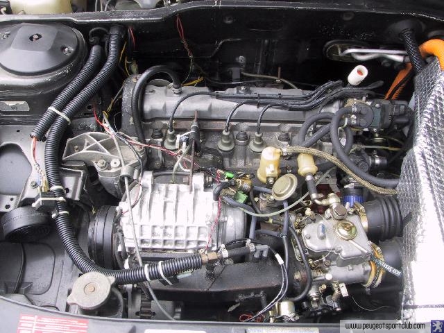

puginfo
yes i run dcoe's on both NA and forcefed in my XU9. pic below. if yr XU9 was fuel injected, keep the ignition and design all else around it. if its a carby version then the dizzy would need some tweeking. a piper cam pulley would be needed to get the power range in where you need it. 32mm would be good till you discover more as you move along.

Wow, never seen that done before.
