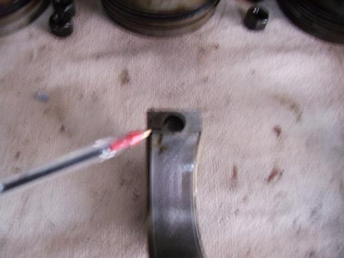

the crank bearing caps (if i understand what your saying) should be fitted so grooves are on both sides
I did actually understand that the groves/slots cut into the cap as shown in your great picture need to be on the same side as the block so the faces that are plain and the faces that have a grove in meet when built up.
Its the bearings that I am having trouble with.
The plain only seem to fit in the caps and the ones with the groves in only seem to fit the block.
As said already in this thread
Peugeot kept changing the number of plain vs grooved bearings for no apparent reason. When you buy a replacement set these days you usually just get 5 of each, so you can ignore what it says in the manual and just the five grooved ones in the block and the smooth ones in the caps.
