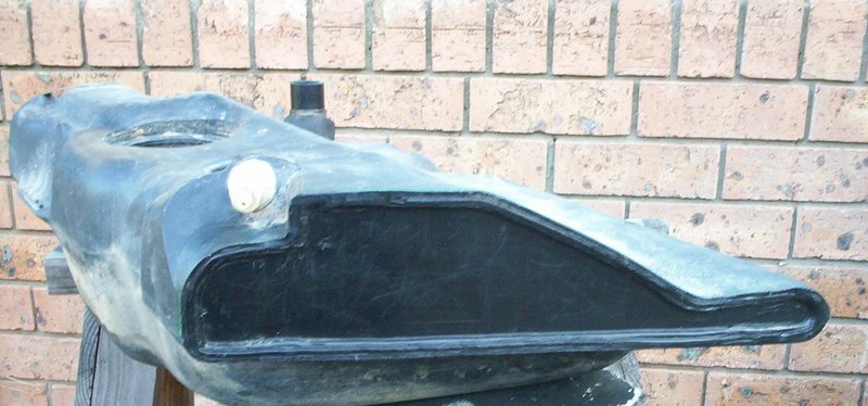

ifcho
I am thinking of chopping my fuel tank as well, as this sounds as the simpliest and most effective solution. I don't like swirl pots, as they add many fuel connections and having a few liters of fuel in the hot engine bay doesn't look great to me :-)
I found the pic petert has posted (after doing many searches, so I'll repost it here):
petert's fuel tank:

I run a cut and shut tank on our track day motor. Run full slicks and only rarely have surge. Looks identical to Pete's tank above. Works very well, especially considering least is best (cost that is !)
At the end of last season we had a small leak, but not from a join but from the exhaust melting the tank. It was a sod to try and resolve, but eventually we did. It took us hours to plastic weld it. On slicks the exhaust moves too much so we've had to create a wire strap mechanism to stop its lateral movement. In addition the exhaust is totally encased in heat wrap, plus the tank is lagged to prevent it happening again.
