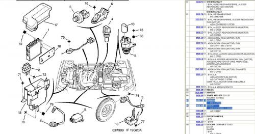

hi guy's,
little problem.... it seems to me, there would exist 2 diff. map sensor in xu10j4r models.
one is looking like a normal mapsensor....the other one is boltet onto the inletmanifold.
problem is:
a friend has a xu10j4r engine, i've changed the inlet into gti-6 one... but he has the problem, that his mapsensor is bolted...die diameter is smaller then the hole for the stock mapsensor :-/
any ideas how to solve this problem? (should use gti6 map or stock-boltet-on-map->fitting??->liquid metal?!)
i'm not sure to compare/measure both sensor's
pic (no. 5 + 6)
regards

I fitted a gti6 manifold to my xu7j4 - i think this should be the same as the xu10 (but maybe not).On this the xu7 map sensor fitted where the gti6 one was-just after the throttle body,the hole was the same size but i had to extend the wires

hey alync,
thx for your replay...you are right, i have also extenden the wires too.
i have used the 6 mapsensor... car is running fine... nice rumble tone too.
but more power... ?!
wich injectors did you used?think you changed only the manifold -right?
