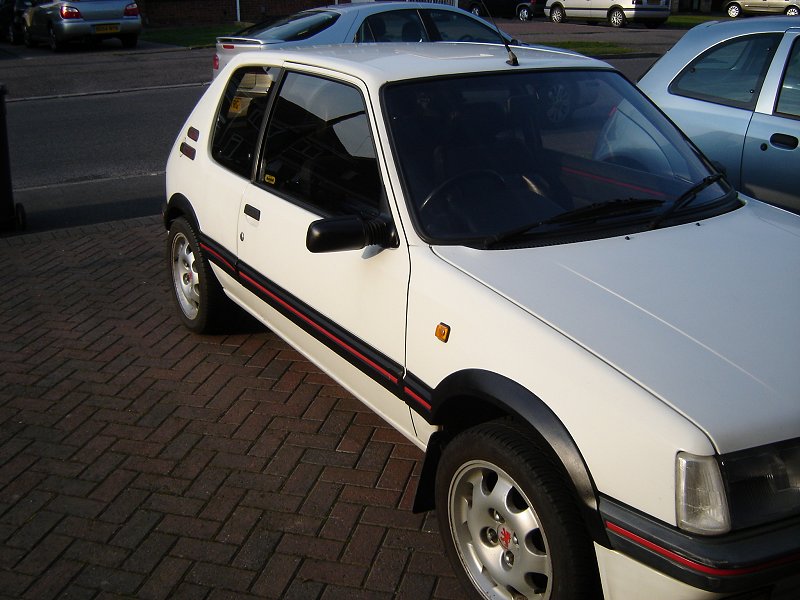

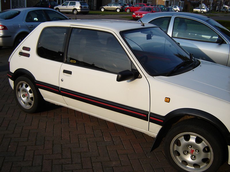

Has anyone got any pictures of their 205 with a 309 rear beam fitted?? just wondered what it sat and looked like. Please post if you have.
Ryan
It fills the rear arches out quite nicely, but there can be some issues with rubbing if lowered too far. Ignore the front height as there was no engine in when these were taken.
Edited by Ryan
milk_churn
Thanks. I'm planning on having the ride height standard so do you think the rubbing won't occur? Do you have to do anything with the front to match or can it be left as is?
