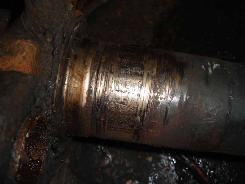

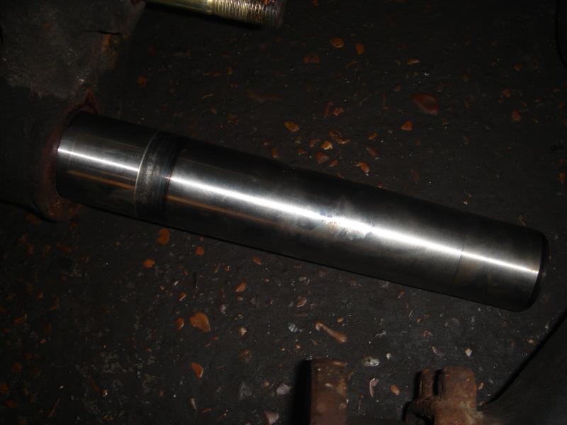

Rom
The camber is caused by the bearings collapasing inside the beam tube. Allowing the shafts to sit pissed. These often knackers the shafts unless caught early. The shafts get very badly pitted and scored.
