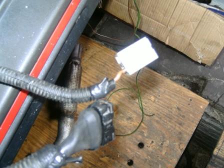

Look for a 3 pin white rectangular multiplug with a green wire, a yellow wire and a bare braid wire, this is where the ignition loom section plugs in. The mini-loom that plugs in there has the connectors for the ignition amp and the coil as well as a two pin white multiplug which is where you supply the loom with a switched 12v feed and also where you get the rev counter feed from.

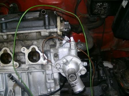

I need some wires for thermostat housing and these green and brown are unidentified

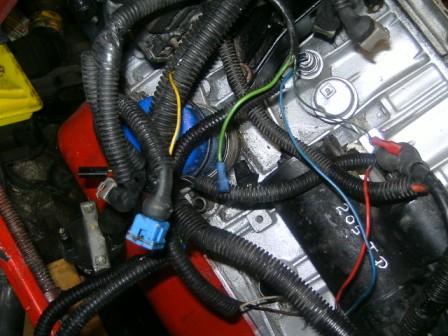

These two stick out of the loom at about the same placepost-9302-1209470696.jpg
This will be the 12v supply and AFM I think

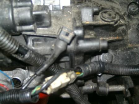

post-9302-1209470957.jpg I only have one blue connector and would love to know where it goes.
I have put red on the starter and I think yellow goes to the oil pressure switch.
there is a plug at the back of engine with brown and green which I think is oil level .
Any help with colours for loose wires would be a great help.
Thats correct.
Thats the ECU coolant temp sensor plug, goes onto a blue sensor on the side of the thermostat housing.
