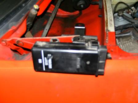

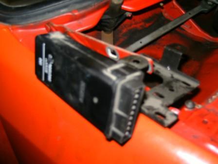

sutol 0 Posted April 24, 2008 This question has been posted before and I read it but I'll be blowed if I can remember what it is for or if it needs to be connected. I remember removing it from under the steering column but I can't remember if it was plugged in. I hope not because I can't find a plug to fit it ! Share this post Link to post Share on other sites
danpug 1 Posted April 24, 2008 Iirc its the alarm for when you leave your lights on??? Share this post Link to post Share on other sites
sutol 0 Posted April 24, 2008 Yep, I think your right. Also got two yellow wires conected to a small spade connector over when plugging the instrument panel back in, can't find where they go either. Not good as I only took it off yesterday Share this post Link to post Share on other sites
BERTMAN 40 1 Cars Posted April 24, 2008 you have an alarm for when youleave your lights on? oooooooo bit posh lol mine dosent Share this post Link to post Share on other sites
pike_1.9cti 0 Posted April 24, 2008 Also got two yellow wires conected to a small spade connector over when plugging the instrument panel back in, can't find where they go either.Not good as I only took it off yesterday Im stuck with the yellow wire aswell! I only replaced the tachy relay but then saw these. Not sure if i knocked them off or whether it was for a extra that was never installed on my car. Thing is haven't noticed anything not working. anybody know? Share this post Link to post Share on other sites
chris1986 1 Posted April 24, 2008 i too have the spare yellow connectors. havn't noticed aanything not working so not bothered about them Share this post Link to post Share on other sites
sutol 0 Posted April 24, 2008 you have an alarm for when youleave your lights on? oooooooo bit posh lol mine dosent Not any more I don't, I can't find anything to plug into it. I think it had a wire goilg to it but not sure. You can bet I'll have a few wires left over so I'll plug one of those in. Share this post Link to post Share on other sites
Miles 331 1 Cars Posted April 24, 2008 Its the remote central locking interface module The spare wire is for the Choke Share this post Link to post Share on other sites
sutol 0 Posted April 24, 2008 Its the remote central locking interface moduleThe spare wire is for the Choke Thanks mate, you don't happen to know what wires go to it do you as I dont have a big plug in the vicinity to fit it and I don't think I disconnected one? Share this post Link to post Share on other sites

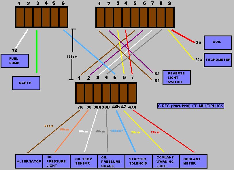

Grim.Badger 15 Posted April 25, 2008 (edited) Are you sure the yellow wire doesn't share a space in one of the brown multiplugs with the thick red wire? You should be able to tell because if it does it will have a very thin/sharp male spade connector. (wire 32a on the diagram below) Edited April 25, 2008 by Grim.Badger Share this post Link to post Share on other sites
sutol 0 Posted April 25, 2008 Are you sure the yellow wire doesn't share a space in one of the brown multiplugs with the thick red wire? You should be able to tell because if it does it will have a very thin/sharp male spade connector. (wire 32a on the diagram below) Yellows are squashed into a normal sized spade connector, but diagram usefull ...thanks Share this post Link to post Share on other sites
