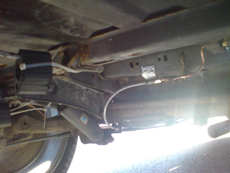

Anton green
Here's mine. Nothing fancy, just a standard cable tie. I have had no problems after 500 miles and do not foresee any, but I really like the split pin and washer idea so should think I will be going down that route shortly, just because.
