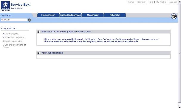

Obviously the first thing you do once you've followed the link is to click on register and complete your details, and then you'll get an email with your login info.
Once you've logged in to the site, you'll see this

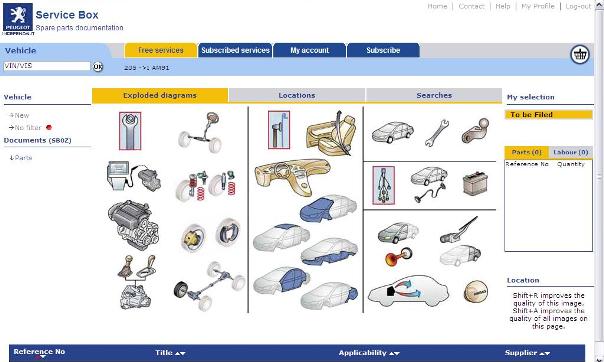

Next you need to go to FREE SERVICES in the upper toolbar, and select Spare Parts Documentation from the drop down menu.

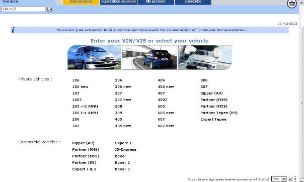

You'll then have to select the model of vehicle for the parts you wish to find

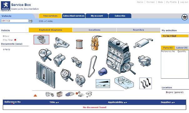

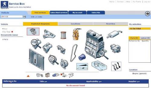

Now you are presented with a screen full of pictures that you can use to navigate around the car to locate specific parts. There is a direct search function to the right, which I'll describe further on. Lets assume I want to find a radiator - the nearest match is the engine icon, since the radiator is part of the cooling system, which is related to engine cooling - so I click on the engine icon
I click on the radiator icon

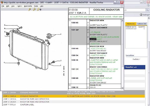

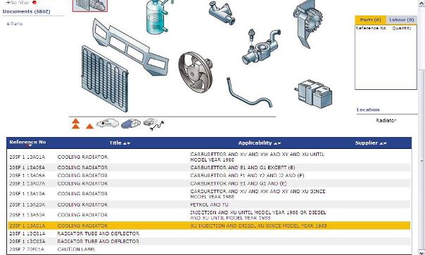

I now have visability of all the components in the cooling system, and I click on the radiator once again. At the bottom of the screen a list of parts is now shown, and I select the most appropriate match

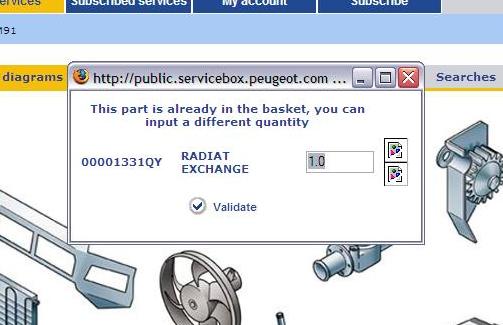

A new window pops up with an exploded diagram of the selected parts, and the various different types at the right side. Once you decide which specific part meets your criteria, double click on that part description at the right side and it will be added to your basket (you can see below, in the original window in the background that I have added 1331QY to my basket)
If you want to update the quantity in the basket, double click on the part in your basket and another window will pop up allowing you to change the quantity. Click Validate when done to close the window

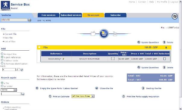

Now you can click on the basket icon in the upper right hand side of the screen, and this will show you the cost of the part you have added (don't worry, you aren't going to purchase it, this just how you find out parts prices via the service)

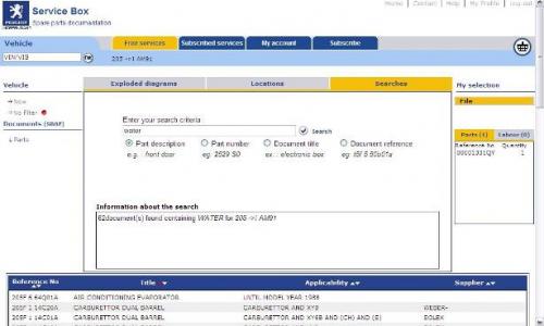

The easier way of searching for parts (providing you are using an obvious descriptor - some parts are named in a less than obvious way!) is to search by keywords or parts numbers (if you have them).

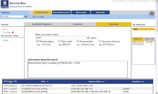

At the screen shown in my 3rd picture in the previous post, if you click on the word Searches in the 3rd orange bar, it'll go to the next page where you can enter your own criteria.
In this example I'm searching for a water pump, so I have entered the keyword "water". I've made sure the check box Part Description is checked and then hit search, and the results are shown at the bottom of the screen (Water Pump is at the bottom of a long list so not visable in this screen cap)
I could have searched by "Pump" alternatively.

Is there anyway to chose model / engine type ? I might be missing something, but im choosing the model ie 106 but not able to choose Gti etc ?
you can with more recent cars, by entering the VIN number, which you can still do for older cars but it doesn't filter the information as much as with newer cars.
