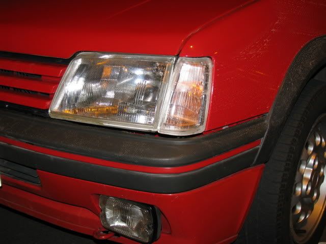

Tom Fenton 1,548 Posted April 17, 2008 Indeed, just wondered really as sometimes these things can be a night-and-day difference. Obviously in this case not so! This link is a bonnet and wing I painted using Celly in the garage, not the best picture, but not so bad paint in my opinion! http://i12.photobucket.com/albums/a221/tom...05/IMG_0093.jpg Share this post Link to post Share on other sites
