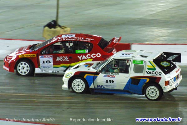

205catcevennes06hugo.JPGlook at the 205 f2000 stuff rather than the 306 ;)
wardy18
that 205 spoiler is PERFECT, where can i get that from?! dont the others, just look silly as they stick sop far up above the car, that 205 one is spot on, what bodykit is that aswel?! looks way better than any dimma kit.........
funny you say that, most of them run a 306 Dimma/Maxi front bumper and the wings are shaped like the 306 wings :D

well i must say i think i could easily make a spoiler which would look along those lines so thats great, at least i know that it suits the cars look from those pics, so that kit is a 306 maxi kit moulded to a 205?!

its a kit in its own right. If you do a search for 'maxi f2000' you will find a few threads with where to get it.
brianthemagical
I think you need to clear up what your after a bit. the std spoiler will be nigh on the biggest thats needed, unless your going reet fast. what your after is a wing, rather than spoiler. the 205 maxi is using a wing, the 306 is using a spoiler. it needs to be in free flowing air, so at least out from the spoiler, with a gap below it. unless your an aerodynaimics expert you'll do nowt with some sheet ali.
so when does a spoiler become a wing? I thought a spoiler only interupts air to redirect flow over the bodywork and therefore helps only reduce lift .
But the 306 one is high up which indicates that its being used to provide downforce as wings are more effective the higher they are as they get uninterupted airflow.
Then again its not attached to a hardpoint on the chassis so its of limited use as a wing i think - like the cupra R race cars
brianthemagical
Your pretty much spot on. A spoiler just, as you say, interupts the sir flow, tripping into being detached and, while creating more drag, prevents the ir flow using the back of the car to create lift. it only needs to be a bit bigger than the boundary layer. A wing is an areofoil section. it actually creats lift, pos or neg, by differing the pressures above and below, exactly the same as an airplane wing. it will work in free flow and create lift, whereas a spoiler will only interupt the air flow.

The 205 Maxi F2000 Carbon fibre one is adjustable too.
I would look into the under car aerodynamics more to get ground effect. That you can do with alloy / plastic. Deeper side skirts may be required though.
