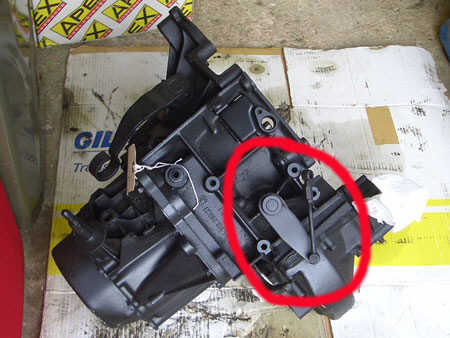

Miles 331 1 Cars Posted March 30, 2008 You need to swap. The top selector arm on the box, Have a search around as if this drop's into the box finding the position is hit or miss, You'll need to swap the cross shaft over as well, This will need cutting out the old box more often than not and swaping over again with your old one, It's worth getting new bushes for the shaft as they are only a few quid for the pair, Worst case if your shaft is shafted (Sorry) you'll need a new one, £50.00 from Pug Share this post Link to post Share on other sites
pug_ham 245 3 Cars Posted March 31, 2008 You need to swap. The top selector arm on the box See attached picture. Graham. Share this post Link to post Share on other sites

pug_ham 245 3 Cars Posted March 31, 2008 I usually put it in gear (5th) when I swap that arm btw, never had one drop so far & I've done three or four. Oh & its double roll pin holding the arm in place, small one inside larger one. Graham. Share this post Link to post Share on other sites
