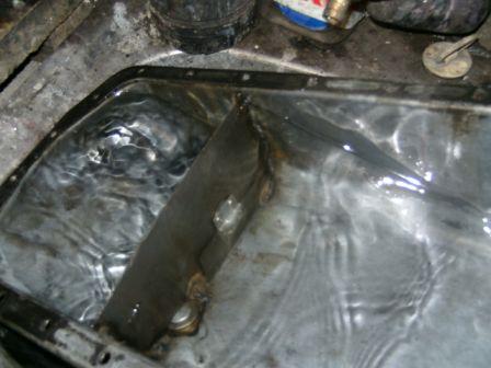

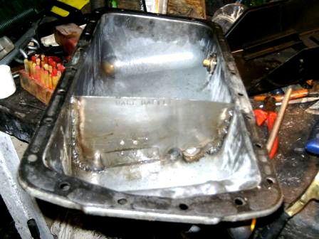

Pulled the sump off my old 1.9 engine today and thought I would try and baffle it. Now my welding isn't the neatest around but it's strong (I always overdo it)
Anyway here are the results and it does hold water back when tipped for 5 to 10 secs so there is always some around the oil pick up point.
I made an experimental pump baffle plate which should work, better than none anyway.
here they are;-
