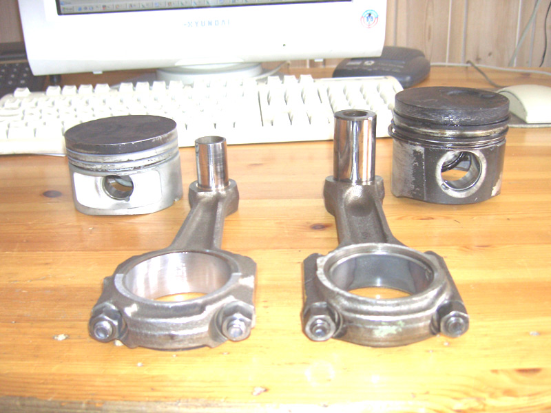

Jakob 1 Posted March 23, 2008 No ,you need either: XU10J4, XU10J4RS, XU10J2TE to have oilcooled pistons.Also some early XU10J4R's does have the oil cooling, but they're hard to find and you really don't know until you've taken off the sump and investigated it. You could get a XU11D block get it rebored to a fresh 86mm (it's 85mm std.) as that one has oil cooling. However I'm not entirely sure about how the waterpump setup on the 2.1 TD block matches with the head from the petrol engine, it will probably be ok, but I've not tried it myself yet. Ok, then I have to find another block than the XU10J2...glad we cleared that up! The Diesel XU11D is a good suggestion - does it have thicker walls to begin with and thereby being the same block as the XU11D? I can see in the other thread that you refer to another guy that have bolted a XU10J4RS head on the XU11D block - then the waterpump setup on the diesel block should somehow match with the petrol head - dont you think, or is the match on a 16v and 8v different? Have anyone ever used the diesel rods for turbo setups (refered to as being more solid/heavier and take more abuse) and in that case does anyone know the lenght? I am beeing offered a 2.1 diesel crank, standard rods (what ever that is), and forced opel GSI pistons 86mm - does anyone have any experience with these pistons? Share this post Link to post Share on other sites
B1ack_Mi16 67 Posted March 23, 2008 Ok, then I have to find another block than the XU10J2...glad we cleared that up! The Diesel XU11D is a good suggestion - does it have thicker walls to begin with and thereby being the same block as the XU11D? I can see in the other thread that you refer to another guy that have bolted a XU10J4RS head on the XU11D block - then the waterpump setup on the diesel block should somehow match with the petrol head - dont you think, or is the match on a 16v and 8v different? Have anyone ever used the diesel rods for turbo setups (refered to as being more solid/heavier and take more abuse) and in that case does anyone know the lenght? I am beeing offered a 2.1 diesel crank, standard rods (what ever that is), and forced opel GSI pistons 86mm - does anyone have any experience with these pistons? Here you can see piston and rod. Left XU10J4TE / T16, right XU11D 2.1 TD. And yes of course as they guy I know put a 16v petrol head on a std. XU11D bottom end the cambelt and waterpump issue should be fine. The 2.1 TD rods are so solid I think they can handle lots and lots of boost The pistons are rather heavy though, also the piston pin is 30mm diameter! Share this post Link to post Share on other sites
