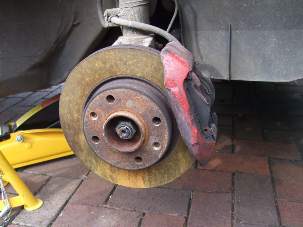

I was told when I bought the car (H plate 1.6) it had 1.9 front brakes fitted. I've done some reading up and the 1.9's normally use Girling.
I'm convinced these are just standard 1.6 bendix calipers, they have bendix and 343144 stamped on them.
I need to order some pads today so they'll be here in time to fit them at the weekend.
Can someone please confirm I'm right in thinking these are just normal 1.6 Gti bendix calipers?
Muchos thankos
yup :blush: offset of the disc shows that its got 1.6 hubs and discs too.
