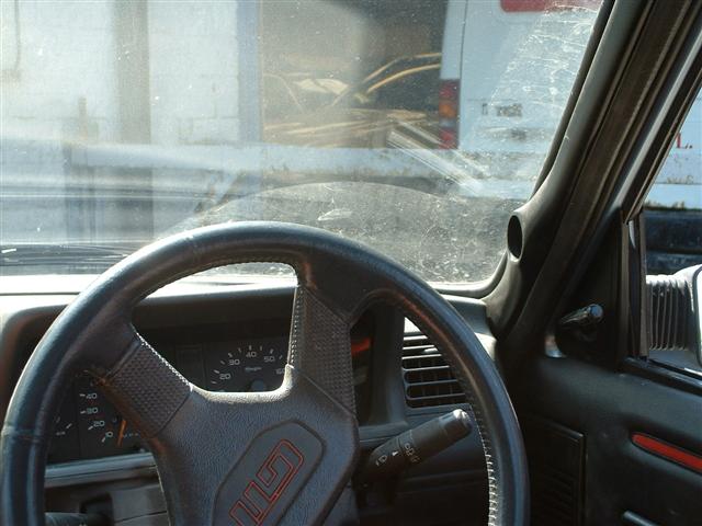

My first 205 had them fitted to the triangular plate where the mirrors mount (commonly called the sail panel due to its shape), but in my current car they are mounted in the A pillar trims firing directly across the car (i.e. facing each other)
Having them here helps to raise the soundstage to an acceptable height (mines on top of the dashboard :D ), and the natural attenuation gained by having the nearest tweeter firing more off axis than the other helps level matching, making the stage more central.
I've no pictures with the tweeters fitted, but here's one of the A pillars I made:

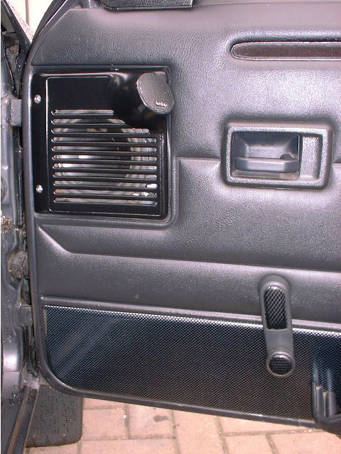

heres my attempt from long long ago :
probably still got them somewhere
