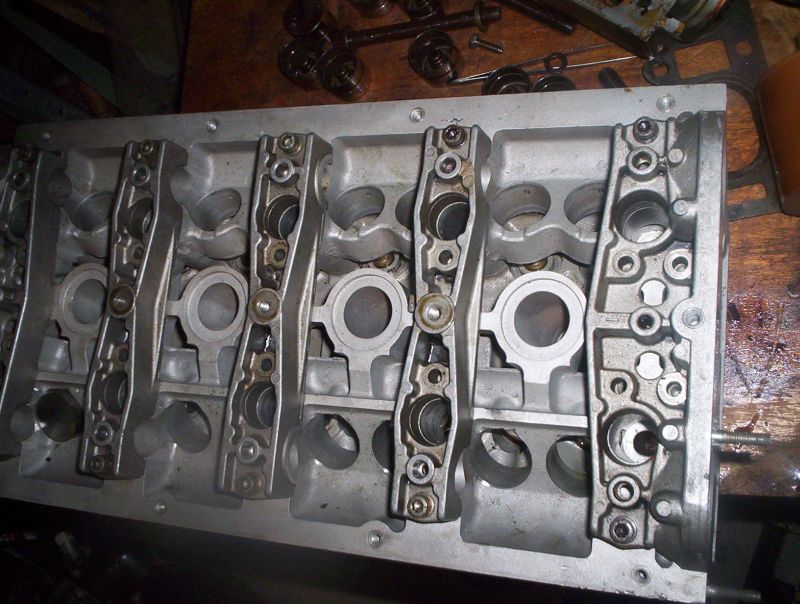

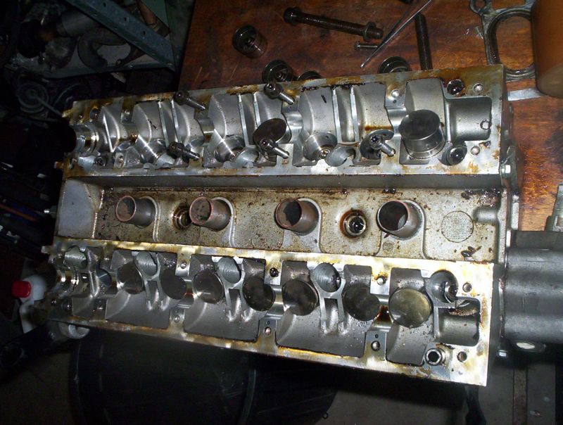

Here's a pic of each type of head. You can see why the oil control in the later engines is a lot better - less space for oil to hang around. Mind you, the size/number of return holes is the same.

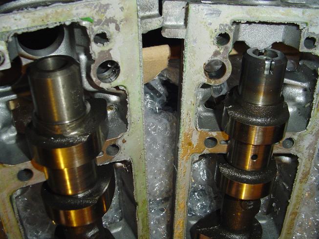

In a desperate attempt to save face, here's a pic of the cam ends:
On the left is the inlet cam (plain), on the right is the exhaust cam (drilled end bearing and slotted end). I was using this set in an XU7J4 head previously, so I blanked to servo pump oil feed by tapping it and screwing in the caphead bolt you can see. Driving in a ball bearing would be easier though!
