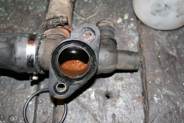

Does anyone know correct size/diameter of the O ring seal for this coolant housing :
http://i27.photobucket.com/albums/c151/Pie...is/IMG_6665.jpg
It's the housing for the coolant pipes at the back of the block near the water pump ..

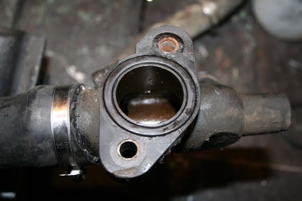

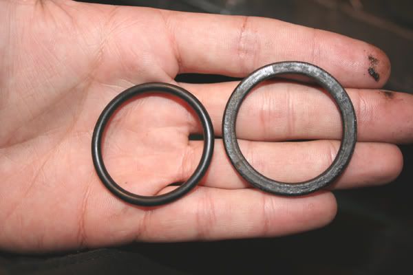

old seal :
http://i27.photobucket.com/albums/c151/Pie...is/IMG_6666.jpg

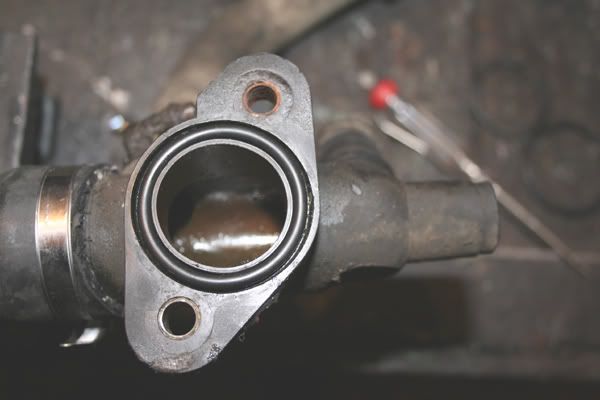

new seal :
http://i27.photobucket.com/albums/c151/Pie...is/IMG_6667.jpg
http://i27.photobucket.com/albums/c151/Pie...is/IMG_6668.jpg

I can't imagine you'll go too far wrong with either the 'o' ring you have together with a bead of silicon, or indeed just the silicon bead, filling the recess.
If the new O-ring sits proud of the face of the housing then it will seal. Diameter isn't so important, it is the section size of the O-ring (ensuring it sits above the face) that does the sealing.
Yes i was thinking to fit the seal together with the sealant , but i remember when i was repairing my mates WV Golf which had leak from the thermostat housing (was a similar O ring sealing system and plastic housing) and i really could not seal it no matter which type of sealant I've been using , with or without the O ring , and eventually I've seal it up when I've bought proper OE WV seal for thermostat housing :lol: ..
Damir
Yes it does but not so much , thats why i was thinking that maybe it needs to be a little bit thicker :lol: as it'll compress down when bolted back against the block surface ..

Grim.Badger
Can you not get the original seal from Peugeot? If you cant get one where you live I'd be happy to order one and post it, I don't think they cost much. I had to replace mine last year and it sealed perfectly. They are a strange seal as they are square sectioned and are flush with the housing surface :lol:
Hilgie
You have to get the seal from Pug. It's only a few pennies.
The one you have put in now is meant to go into the thermostat housing :lol:
